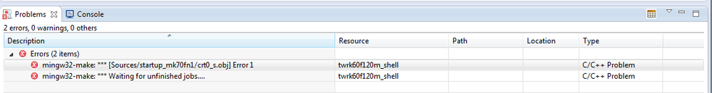

cencongsu
I download the latest fNET V2.7.5 and import the shell demo of mk60fn1m to Codewarrior 10.5 to build the project, but error occur:
Here is the console log, how to fix this error?  thanks.

C:/Freescale/CW MCU v10.5/MCU/ARM_Tools/Command_Line_Tools/mwasmarm|Assembler|Error
(C:\FNET\FNET 2.7.5\fnet_stack\cpu\fnet_cpu_config.h|368|0|0|12859|0)
=#if (FNET_CFG_CPU_TIMER_NUMBER<0)||(FNET_CFG_CPU_TIMER_NUMBER>FNET_CFG_CPU_TIMER_NUMBER_MAX)
>Expected operator, got U
'Finished building: C:/FNET/FNET 2.7.5/fnet_demos/common/startup/startup_mk70fn1/arm_cm4.c'
'Finished building: C:/FNET/FNET 2.7.5/fnet_demos/common/startup/startup_mk70fn1/vectors.c'
'Finished building: C:/FNET/FNET 2.7.5/fnet_demos/common/startup/startup_mk70fn1/start.c'
'Finished building: C:/FNET/FNET 2.7.5/fnet_demos/common/startup/startup_mk70fn1/drivers/lptmr.c'
'Finished building: C:/FNET/FNET 2.7.5/fnet_demos/common/startup/startup_mk70fn1/sysinit.c'
'Finished building: C:/FNET/FNET 2.7.5/fnet_demos/common/startup/startup_mk70fn1/drivers/nfc.c'
'Finished building: C:/FNET/FNET 2.7.5/fnet_demos/common/startup/startup_mk70fn1/drivers/mcg.c'
'Finished building: C:/FNET/FNET 2.7.5/fnet_demos/common/startup/startup_mk70fn1/drivers/cache.c'
'Finished building: C:/FNET/FNET 2.7.5/fnet_demos/common/startup/startup_mk70fn1/drivers/pmc.c'
'Finished building: C:/FNET/FNET 2.7.5/fnet_demos/common/startup/startup_mk70fn1/drivers/rcm.c'
'Finished building: C:/FNET/FNET 2.7.5/fnet_demos/common/startup/startup_mk70fn1/drivers/rtc.c'
Errors caused tool to abort.
mingw32-make: *** [Sources/startup_mk70fn1/crt0_s.obj] Error 1
mingw32-make: *** Waiting for unfinished jobs....
1,617 Views
simonteki
I had an U to many. The quick and dirty solution was to delete it.
#define  FNET_CFG_CPU_TIMER_NUMBER_MAX              (3U)    ->
#define  FNET_CFG_CPU_TIMER_NUMBER_MAX              (3)
