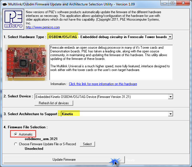

I have not seen these problems before, could you please try updating the firmware version of the Tower boards presenting the problem using the P&E Updater utility?
Also make sure that the jumper settings are in its default setting.

v_snicarevs
All the boards at firmware version 31.21 (also confirmed by P&E Firmware Information Utility).
Drivers are also recent.
