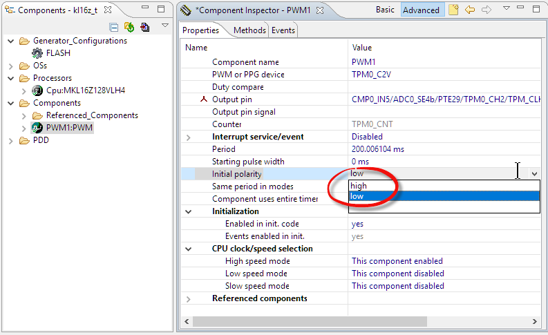

We have a Kinetis KL16Z128
We have the requirement to run two PWM signals at the same time.
One of the signal's polarity should start high, and the other starts low.
1) It seems there is no way to make the initial polarity high. Why is this?
2) We get an "undefined error" when trying to use PWM_Enable and Disable in our main.c on the Processor Expert PWM components.

I don't have that KL16, but I see it is possible to set the initial polarity here:
To have the Enable and Disable available, you should turn them on with the context menu:

Hi Ethan,
The KL16 TPM does not support 'high' initial polarity.  Erich has a post on the topic.
   Tutorial: PWM with Processor Expert | MCU on Eclipse
The problem is the PWM component doesn't support initial high.  See the community link below which applies to FRDM-KL25Z and would apply to KL16 as well.
   https://community.nxp.com/thread/339065
If you have selected "Enabled in init. code" for the PWM, this is done automatically and you should not enable separately in your code.  If you do, Deinit should be called first.
