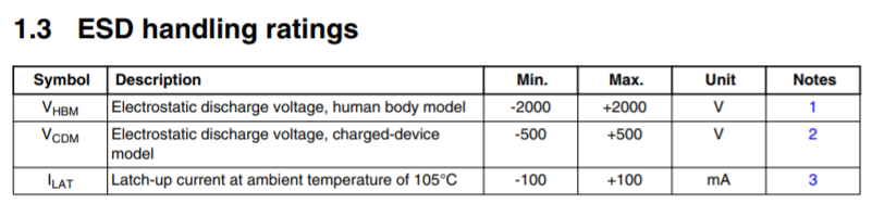

I want to know what is the maximum electric charge k64 and k82 microcontroller can support.
To be more specific, what is the ESD limit on this microcontrollers?
Thank you for your help.
Sincerly.
1,534 Views
adriancano
You can see data on the specific device data sheet in section ESD handling ratings. In example, for K64 https://www.nxp.com/docs/en/data-sheet/K64P142M120SF5.pdf
