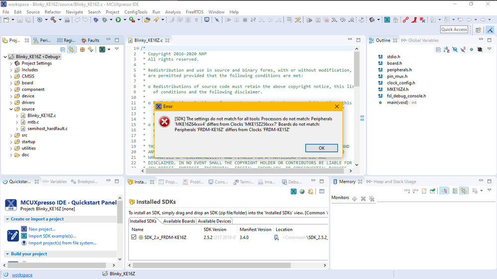

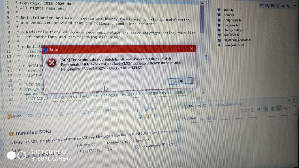

I had started building a project using the FRDM-KE16Z evaluation board. I downloaded the required SDK from the NXP's SDK Builder. Without any alterations I installed the SDK on the MCUXpresso IDE. And subsequently started making the project. But the time I selected the option Open Pins in MCUXpresso Config Tools I encountered the following fore-mentioned error.
I tried the same thing with another board and it worked fine. I also tried the solutions given on the community but they don't seem to work in my case.
Please help resolve the issue as soon as possible.

Hi Kaustubh Gautam,
 Which MCUXpresso IDE version you are using?
 I am using MCUXpresso IDE v11.1.0 [Build 3209] [2019-12-12], didn't find your mentioned open pins issue.
 My project is the led_blinky, my SDK is SDK_2.5.2_FRDM-KE16Z.zip.
You also mentioned the solutions given on the community , please also share the related link.

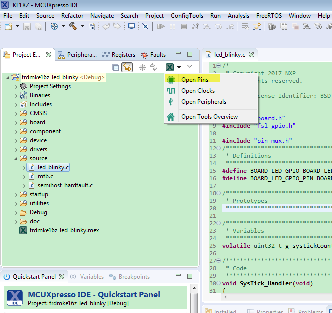

kerryzhou
Hi Kaustubh Gautam,
  What's your PC operation system now? win10?
  Which button you have clicked when you meet the issues? You need to click open pins like the following picture:
  BTW, when you download the new IDE, do you open the new workspace, instead of the old workspace?
