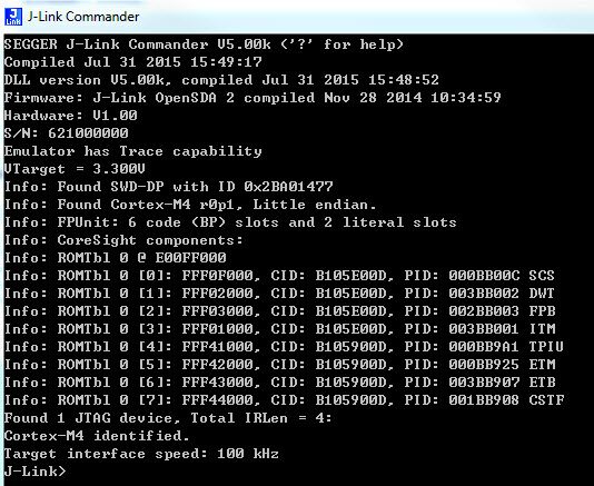

ERROR: Can not read register 1 (R1) while CPU is running

Connecting to J-Link...
J-Link is connected.
Firmware: J-Link OpenSDA 2 compiled Oct 13 2015 12:10:56
Hardware: V1.00
S/N: 621000000
Checking target voltage...
Target voltage: 3.30 V
Listening on TCP/IP port 2331
Connecting to target...Connected to target
Waiting for GDB connection...Connected to 127.0.0.1

Starting target CPU...
ERROR: Can not read register 15 (R15) while CPU is running
...Target halted (PC = 0x00000000)
Reading all registers
ERROR: Can not read register 0 (R0) while CPU is running

可以編譯,但是寫入時就出現這個,K22F無法正常運作
2,756 Views
jeremyzhou
The Fig 1 illustrates the normal connection between the OpenSDA Jlink and the FRDM-K22F120.
So I was wondering if you can tell me what the board you use.
