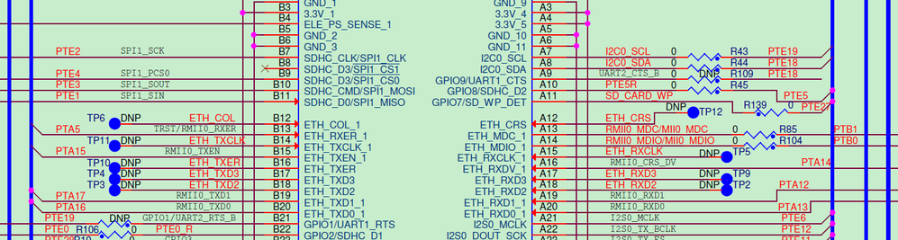

The TWR-SER Ethernet PHY KSZ8041NL supports both RMII and MII interface, while the TWR-K70F120M board doesn't connect MII pins to PCI interface. Please check below TWR-K70F120M board schematics with MII pins "DNP":
So, the TWR-K70F120M board doesn't support MII interface with TWR-SER board.
Thank you for the attention.
Ma Hui
