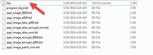

There is one more question need to discuss with you regarding the key file.
Currently I config the key as zeroes and enable encryption.
How and when to use the key as none zero?
Where can find the key file in bootloader source code?
Thanks.
7,300 Views
jeremyzhou
Hi Kyle,
First of all, I'd glad to hear that you can update the application successful.
Regard to advanced usage: encrypted image, I'd highly recommend you to refer to the Chapter 6 in the Kinetis Bootloader QuadSPI User's Guide.pdf, and you can also find the key file which resides in the  ~\NXP_Kinetis_Bootloader_2_0_0\NXP_Kinetis_Bootloader_2_0_0\doc.
