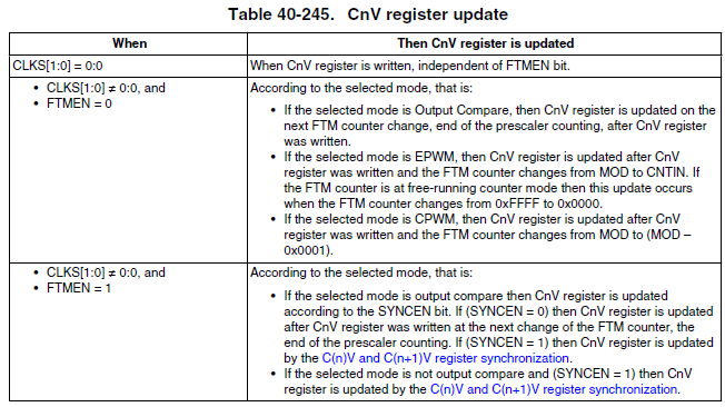

I am using MK60 Flex times for pwm generation. I have the pwm going in the complemetary mode where the dutycycle is controlling the speed as well as the direction of dc motor. The motor runs fine but as soon as I update the dutycycle the motor stops. I can see that the registers C0V and C1V update with the new dutycycle values but at that point the motor stops. I am not sure why this is happening. Did anybody run across this issue or have any idea why this might be happening? Thanks much for the help.

if (counter>2 & counter<=8){           // I have defined an infinite counter in the main loop.
FTM0_C0V =0x0EE;                                    <--------------Motor stops running here.
FTM0_C1V =0x0EE;                                    <--------------Motor stops running here.

You need to check when is the register being updated, depending on the mode the FTM is working, you can check it here in the CnV register update table (reference manual chapter 40.4.10.3):
