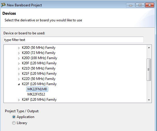

HI Alex:
I think Codewarrior 10.6 support MK22FN1M0 trace feature now, because I can create a project based on K22FN1M0. My codewarrior version is 10.6.4
