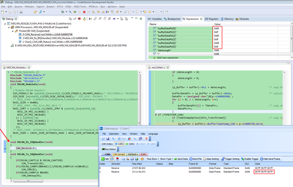

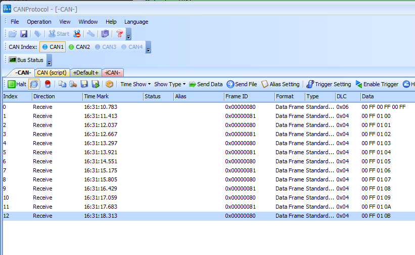

I am not sure if you have test the "Demo_ReceiveTransmit" case.
You can refer the images attached to achieve communicate with each other MCUs.
Please download "ReceiveTransmit" project to one board first.
Then download "Transmit then ReceiveTransmit" project to another board.
I also attached these two project here, so you can test them directly.
If you have CAN bus tool, you may see the CAN data like below.
Robin

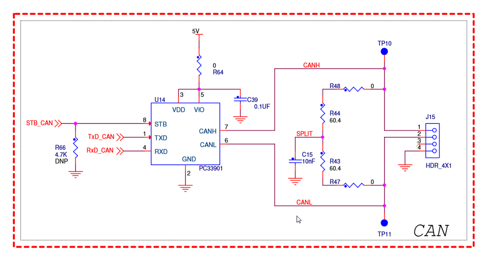

I test the MSCAN_KEA128 project on my Rev D TRK-KEA128 boards.
The "Demo_Receive_DataFrame" code can run into MSCAN_Rx_IRQHandler.
There is some difference between these two version. REV D uses PTG0 pin to control the STB of MC33901, while REV B ties it directly to GND, so you have to set PTG0 as GPIO output function and set it to low, so that it makes MC33901 in normal mode.
Robin

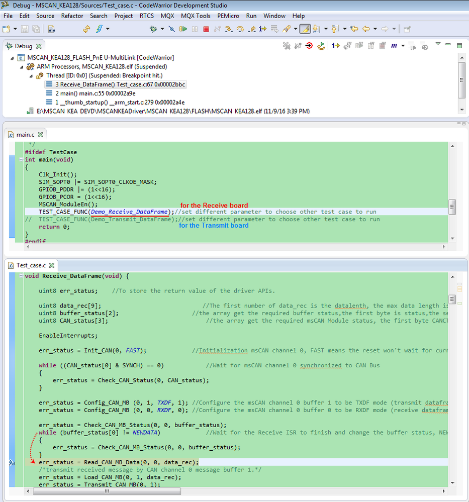

You just need to connect CANH(Pin1 of J15) and CANL(Pin2 of J15).
When debugging with CodeWarrior10.7 on the Receive board, I add a breakpoint waiting for the NEWDATA.
After power on the Transmit board by another computer, the Receive board will stop at that breakpoint.
The project can be download from MSCAN driver for Kinetis EA devices.
I also attached the project here.
Robin

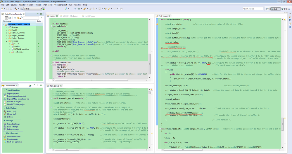

Robin_Shen
Hi Tyler,
That code is used to output Bus clock on PTH2. I just want to ensure the frequency of Bus clock is correctly configured by Clk_Init function.
Robin

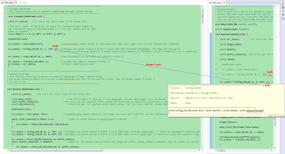

tylertrigg
Upon further inspection, I still am having some sort of trouble. Let me tell you a bit about my setup. I have a laptop that is running Transmit then ReceiveTransmit and a desktop that is running ReceiveTransmit. Just like when I was using the regular transmit and receive data frame functions beforehand, I can transmit from my laptop and receive from my desktop just fine. However, when I try to transmit from my desktop, the laptop cannot pick it up.
The laptop can pick up the signal if the desktop uses the ReceiveTransmit function to send it, but not when it uses transmit. Do you think that may be caused by differences in power they may be receiving? Or do you have any other suggestions? It doesn't appear the code is at fault, and I've checked both the wires and the MCU's and have switched them, so it doesn't appear to be a problem with the devices. It's just that either whatever is plugged into my desktop cannot transmit or my laptop cannot receive it without using the ReceiveTransmit function.
Tyler
5,113 Views
Robin_Shen
Hi Tyler,
I think this was caused by frame ID.
The the msCAN channel buffer ID of receiver should be configured equal to the ID of transmitter.
Otherwise the receiver will can't pick up the signal.
Robin
