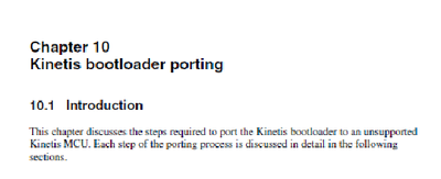

Hi Daniel,
Thanks for your response, I would like to develop a custom bootloader could you share a general document to steps to be followed in the bootloader development.
Thanks & Regards,
sivakrishna
2,715 Views
danielchen
Please refer to chapter 10. Kinetis bootloader porting from Kinetis Bootloader Reference Manual.
