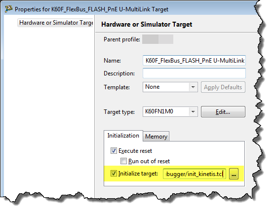

Jorge_Gonzalez
Hello Renjith:
I guess this is because the Flex Bus is not configured yet when launching the debug session, so when the debugger attempts to read those addresses, it crashes.
In case this is the problem I attached a script which contains Flex Bus initialization code. Go to Run -> Debug Configurations -> (Select your connection) -> Edit -> Edit (again), and in the "Initialization" tab point to this script file. Check below:
With this the debugger should be able to 'see' the external memory without hanging.
Regards!,
Jorge Gonzalez

renjithvamanan
Hi Jorge
Thanks for this input.
Flex Bus was not initialized in the tcl file as you guessed. But even after using your tcl file, debugger connection is losing same as before.
But when I tried my same .mem configuration file in another PC and HW board, it worked even without Flex Bus initialization in tcl file.
It worked on the first run as expected and I could view the contents of Ext.SRAM variables.
Does this hints help some how ? What could be the reason that it is not working in my debug setup?
Renjith
