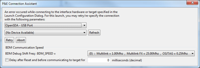

Hai,
I have debug issue.Please any one help me. I  have pasted that error screen shot.
Senthil.
1,663 Views
adriancano
Do you have the OpenSDA PE drivers installed? If not you can download them from here P&E Microcomputer Systems. Install the drivers and then attach our device.
Also you have to have your device in DEBUG mode. You can check the instruction to set your device in debug mode in the section 2.1 of this Document: http://cache.freescale.com/files/32bit/doc/user_guide/OPENSDAUG.pdf?fpsp=1&Parent_nodeId=13475551765...
Once you did that try to download and debug your project again.
