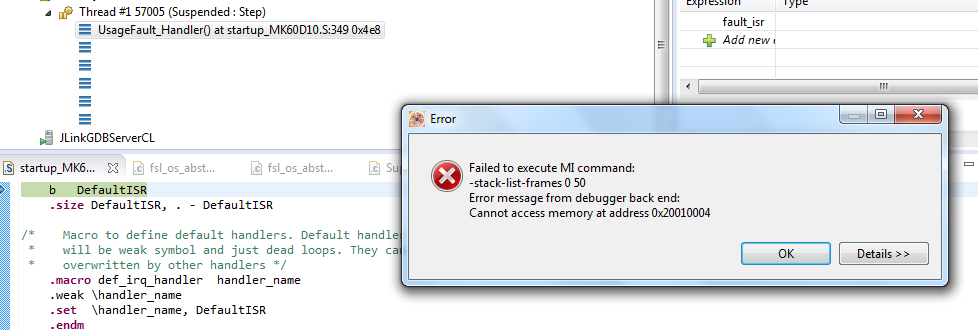

When my debug stucks, I am able to see that, there are lost of ISR functions in my debug window in thread 1.(Please see image below).
One more thing, register values like CFSR, HFSR, BFSR etc are coming different every time on different debug.

Though there is dissimilarities in register values, I got same ISR functions is debug window and  I got the same value for fault_isr, that is 3.
Now in my MK60D10.h file,
/* Device specific interrupts */
DMA3_IRQn = 3, /**< DMA channel 3 transfer complete */
One more thing on debug stucks, I got the popup indicating me "cannot access memory at address 0x20010004" (see
image below). What is this indicating?
Is this creating a stuck?
I also tried to disable my dmacontroller component,disabled tasks which are using this dma facilities, but still my code stucks.
Should I have to look for dmaISR function, or for Isr functions which are indicated in debug window like, uxListremove() or xTaskRemoveFromEventList() or xQueueGenericSenfFromISR etc...?
How to solve this stucking problem? Which ISR is causing a problem? How to know that?
Please suggest what do next.

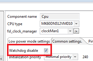

utsavikalpesh
Contributor V
Hi Mark,
Thanks for reply. As you said, it is possible that watchdog interrupt is fired. But from the CPU component I can see that Watchdog is disabled. Please see the snap below.
How can watchdog interrupt triggered?? End though it is triggering then how can I prevent that?
There is no problem in our code at startup but,whenever our Ethernet task(TCP communication) start and after apprx 10min later task hang on DefaultISR.
