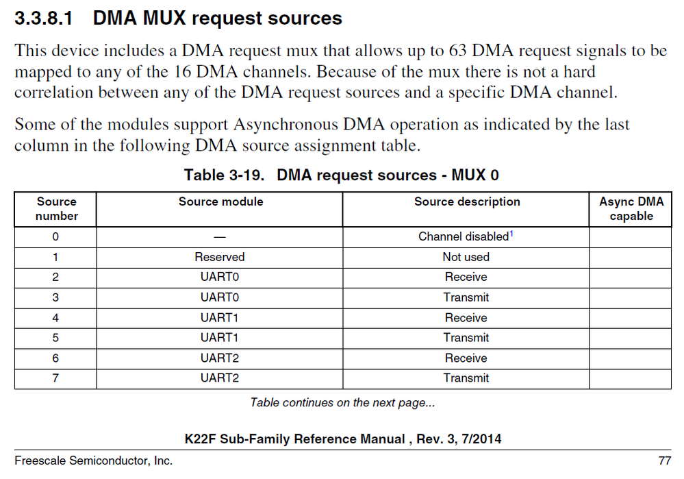

I'm looking for the DMA Channel Sources for the K22FN512VLH12 (Freedom K22 Board processor), but can't find them.  These are the values written to the DMAMUX_CHCFGn registers.  The reference manual says to see the chip specific documentation.  The data sheet for this chip (see data sheet) doesn't seem to have it.
I'm using KDS 3.0 and the include file, MK22F51212.h doesn't have them either.
Any ideas?
Thanks.

DMA sources are always in the user's manual - for the K22FN512:
This are the DMAMUX0 trigger defines from the uTasker project (when K22FN512 is used); I don't think that the NXP references support portable DMA usage and so the values probably need to be looked up and hard coded for each processor type that will be used.
