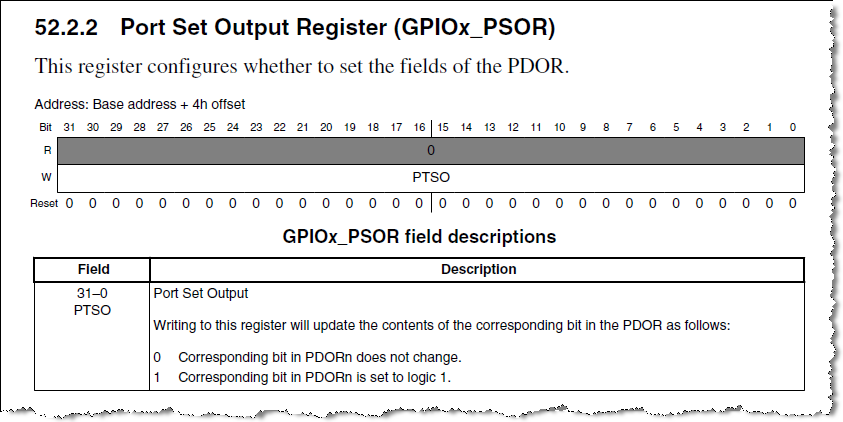

I am using Kinetis MK22 MCU. I want to transfer data from memory to GPIO PortC using DMA. When I gave TCD0_DADDR = address of GPIOC_PSOR, the DMA is not working as expected (i.e the data is not been transferred to  DADDR). Does MK22 DMA support GPIO registers as destination address?

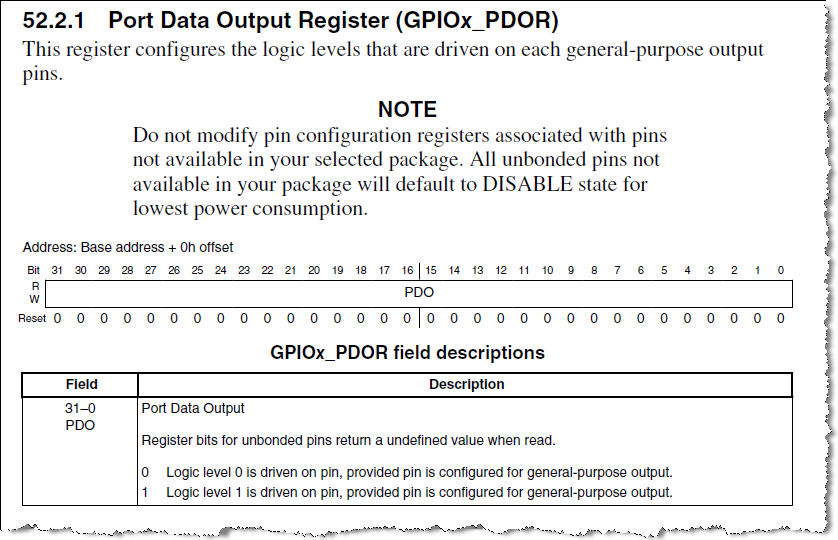

I think you'd better use GPIOx_PDOR instead of use GPIOx_PSOR.

swa14720
Thanks @robin_shen
Thanks for your help. I figured this out and exactly that was the issue.i was trying to write onto psor and read from it. But psor doesn't support read. When I changed Daddr to read from pdor it worked perfectly.
