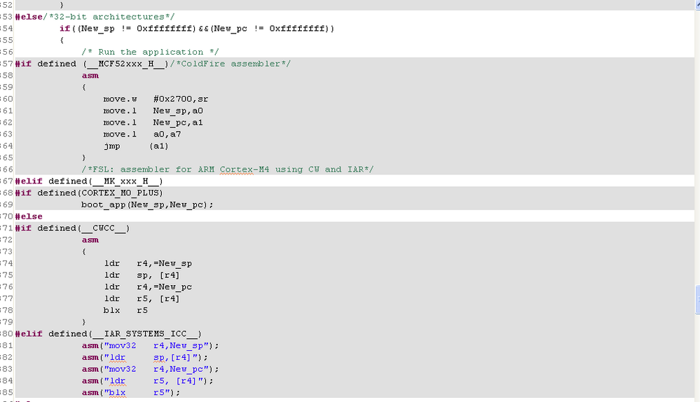

I read the code, but I didn't get which part and which  function is used for check valid user application code.
The reason why I want to check this is because I followed the AN4370 instruction download a user application code, but after I press the reset button, it can not run the user application code. The weird thing is that it also doesn't enter the bootloader mode either. (I am using CW2, K60N512.)

Hi Daniel,
The part used for check valid user application code is shown in the following snapshot. Please kindly refer to it for details.

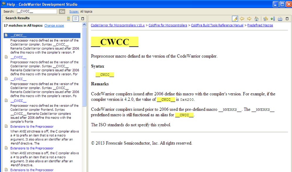

Hi Kan,
In my project, this part is commended out by default. Then if I want to use K60, do I have to add the check application part myself?

Hi Daniel,
Seems you are using CW 10.4, so that part enclosed by __CWCC__ would be used in the application, you know, it is a predefined macro, so the text viewer would treats it as undefined while viewing. Sorry for the confusion that has caused. Please kindly refer to the following for more details.
