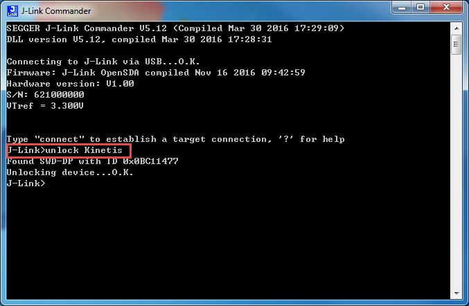

The KM34Z256VLL7 is using the same ARM Cortex-M0+ core, which has the same debug design with Kinetis L family product.
Customer could consider to use Segger J-Link commander tool to unlock the KM34Z256VLL7  product:
Ma Hui

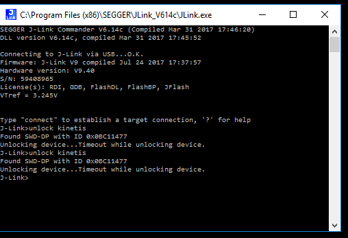

armaram
Hello Hui Ma,
I tired that and got a timeout response. I've attached a screenshot for your reference.
Arvind

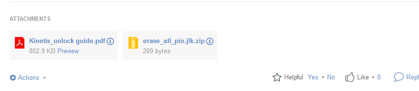

I would recommend to use below thread attached J-Link Command script file:
Thread link is below:
https://community.nxp.com/thread/439921
Wish it helps.
Ma Hui
