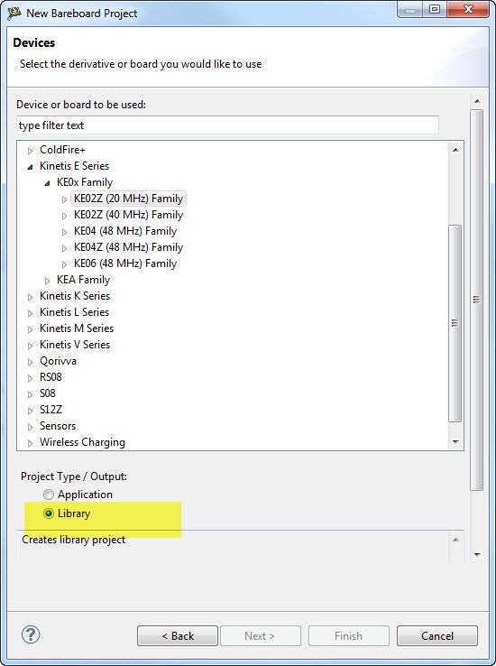

if using CW10.6, user can create a customized library with wizard:
can this help you?
