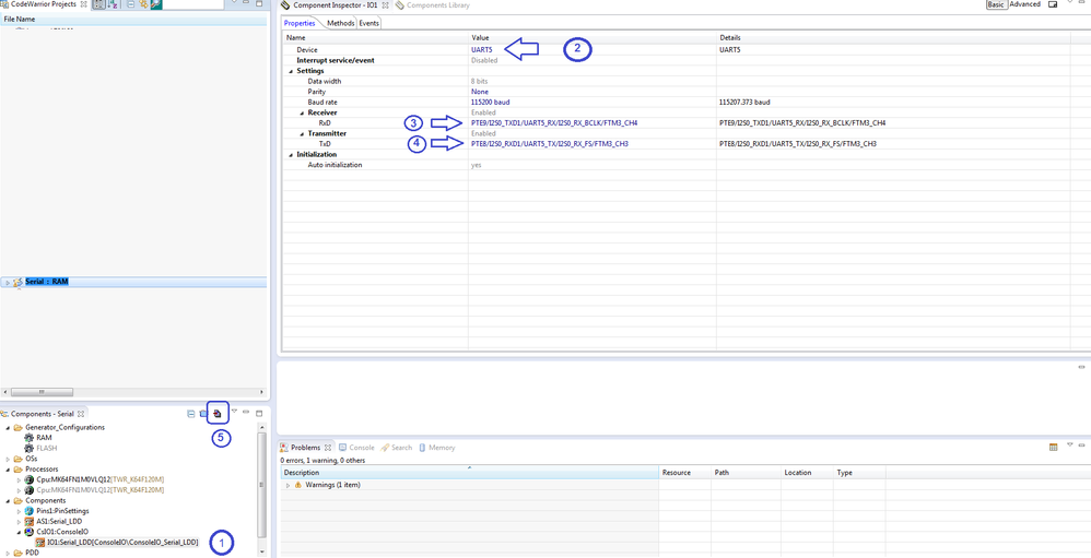

I have been able to get the example projects that where supplied with the package to work. I have also been able to edit the projects, adding my own c code (simple code, like creating integer arrays, basic loops). At the moment I am just practicing to program in C so nothing too complicated with the board. I have been using the putty terminal to practice programming in C.
My problem however is that I have tried to create my very own project and practice programming on a brand new project rather than editing the example projects. When I created my own project, I just put in a simple printf() statement, but I got errors saying saying something about WriteUARTN, ReadUARTN.....
So my question is how do I create a new project that I can put onto the board (maybe toggle LEDs for example)?

Please check the image below, these are the configurations you should have in your Console component:
Also I did a simple project to test this issue; in the attachments you can find my project.
Note: Be careful with the syntax of the printf function, it could be a problem sometimes.
I hope this information can help you.

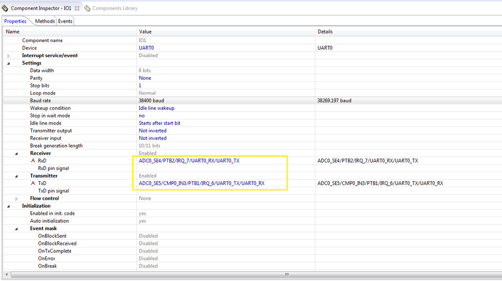

I selected PTB4/UART0_RX and the PTB3/UART0_TX. How can I change the pins that you are specifying?
When I compile the project, I get no errors. It builds the .elf file, .s19 file and so on.
Don't I have to initialise the pins in the code itself?

adriancano
Processor Expert will do the appropriate initialization of the module, you just need to set correctly the values you want in the Processor Expert's interface. The image bellow shows you where to change the pins value for the ConsoleIO component: (the names and values do not correspond to your project because this picture is for another project I have but the steps are the same).
1. Select the Serial_LDD component.
2. Select UART0
3. Select PTB2/UART0_RX in the Receiver pin.
4. Select PTB1/UART0_TX in the Transmitter pin.
5. Generate processor expert code.
With this changes the UART0 is configured to send and receive data through the OpenSDA feature to a terminal in your PC.

markadamson
That'd the interface I have been working with however, I don't get PTB2 and PTB1. The image I have provided only shows PTB4 and PTB3UART0 screenshot.png

adriancano

markadamson
Apologies for the late reply. Thank you for the example project and steps that you provided. I managed to follow it and create my own project, displaying Hello World.
