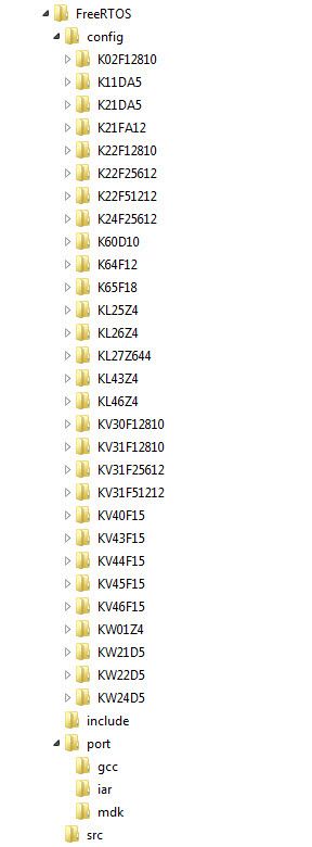

       Next, I’m going to show you the steps of creating a MAPS-K22 FreeRTOS demo by IAR and I’ve also attached a template demo and FreeRTOS source code (Fig 1).
Fig 1 FreeRTOS source code directories and files
    1. Copy the FreeRTOS source code to ~\MAPSK22_SC\Libraries

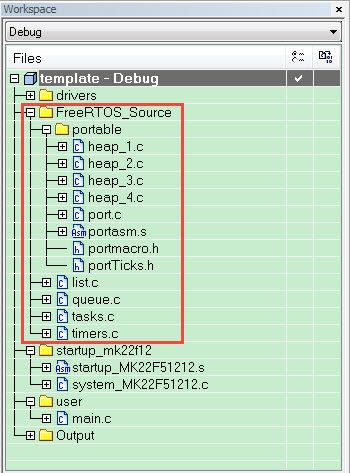

    2. Create FreeRTOS_Source group in the workspace, then add the source code (Fig 2)

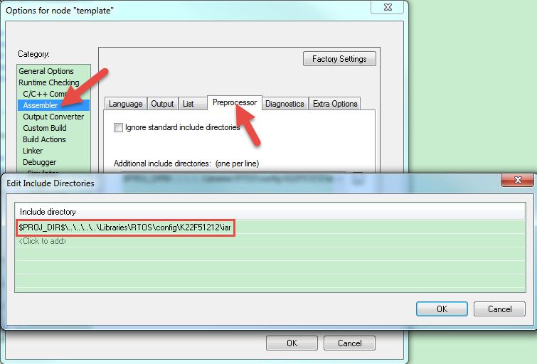

4. Modify the Include Directories

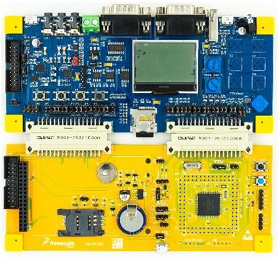

After build the modified application code, then run it on MAPS-K22 board (Fig 3)
