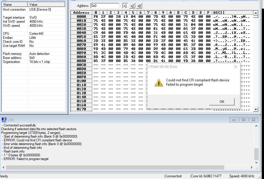

While re-programming our KM34Z256VLL7 we get the message 'Could not find CFI compliant flash device".
I tried all options, power cycling, multiple resets, unlock kinetis, etc. but nothing seems to work.
Can anyone please help? Following is a screen shot of the error and also attached is a log file which might help you understand the problem better.

I got the same message and the problem was the MCU not begin correctly set.
Go to Options > Project Settings > MCU
Then click on the "3 dots" to choose the correct Device.
Then close with OK, and it should work.

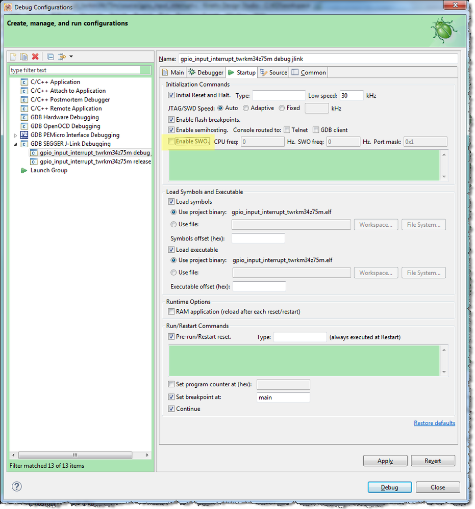

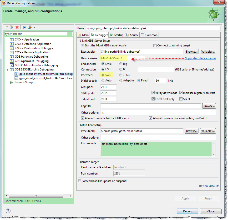

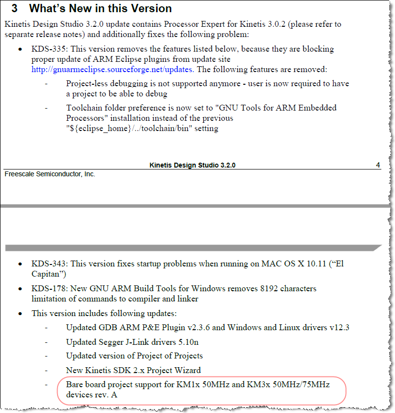

According to the KDS_Release_Notes, it seem's that KM34Z256VLL7 is newly supported in KDS3.2.
If you set the Debug Configurations of KDS3.2 like below, will the problem still happen?
