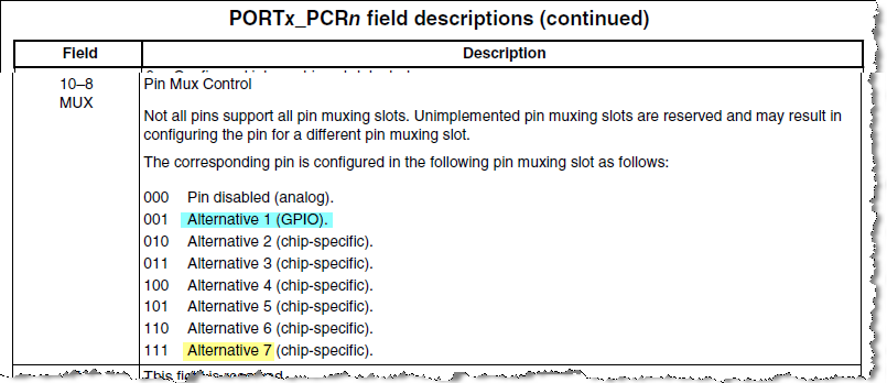

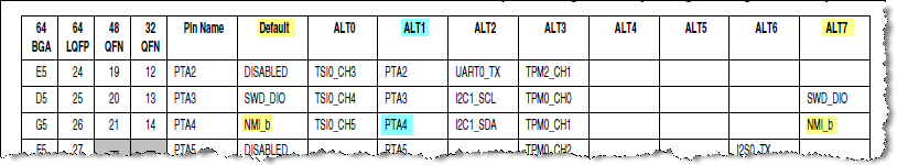

Hi Sheng Deng,
This pin is default as NMI_b function.
PORTA_PCR4[MUX] can be used to switch the PTA4 pin from NMI_b function to GPIO function.

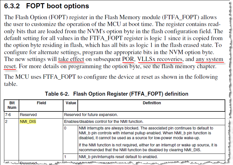

Due to NMI interrupt is enabled by default. You may need to disable the NMI interrupt by clear FTFA_FOPT[NMI_DIS]. (Notice: The new settings will take effect on subsequent POR, VLLSx recoveries, and any system reset.)
