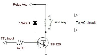

I am using Kinetis KLO M0 family as requirement and I have to
run a relay that is supplying 277VAC @ 5A to the load.
Also I need to be turning it ON and OFF every 9 seconds. I am
wondering which outputs should I be using.
I can design the power conversion needed, but I am not much
familiar with Microcontroller.

Yes I will be driving Relay by driving the transistor or the FET using the MCU.
4,210 Views
LuisCasado
You can use any GPIO of KL0x MCU. But you will need a external driver, a small transistor is enough, a darlington transistor is much better, like MPSA14. It depens on the voltage and current you need in the relay coil, tipically 12V and some mA. You will need a parallel diode with the relay coil.
http://www.onsemi.com/pub_link/Collateral/MPSA13-D.PDF
Something like this:
If you need to drive multiple relays, you can use an ULN2803, for example.
Luis

So GPIO of KLOx MCU is connected to TTL input of the transistor??
Also which clock should I use to drive the circuit ON and OFF every 9 second?  and how will it control my GPIO output?
(MCGOUTCLK, MCGFLLCLK, MCGPLLCLK, OR something else??)
Victor
4,210 Views
LuisCasado
Yes, GPIO to resistor.
You can use any timer (TPM, LPTMR) to generate a basetime to count seconds and drive the pin when you need.
Luis
