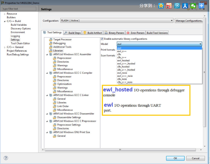

    Do you mean, when you use the JTAG interface, eg SWD, you can debug the code, and when disconnect the debugger, just POR, the APP can't work?
    What the IDE you are using? CW, KDS or MCUXPresso?
    If you are using the CW, please check this configuration:
You need to chose ewl instead of ewl_hosted.
Please try it on your side, thank you.

   Thanks for your input. I am using MCUXpresso IDE for development. I am able to use the controller in debug mode(i.e with SWD) but it doesn't work without SWD(Normal operation mode). Also please check whether the RC value connected on the RESET pin is sufficient or not.
