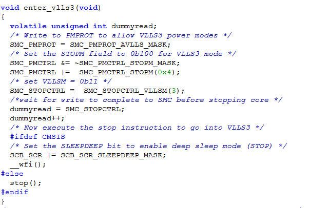

Hi All,
I have cw10.4 and MQX4.0.1. And I add some code in my main task to control the MK60FN1M0VLQ12 to enter the VLLS3 power mode.
The code is as following:
MCG_C6 &= ~(0x20u);
/* Write to PMPROT to allow VLLS3 power modes */
SMC_PMPROT = SMC_PMPROT_AVLLS_MASK;
/* Set the STOPM field to 0b100 for VLLS3 mode*/
SMC_PMCTRL &= ~(SMC_PMCTRL_STOPM_MASK);
SMC_PMCTRL |=  SMC_PMCTRL_STOPM(0x4) ;
SMC_VLLSCTRL =  SMC_VLLSCTRL_VLLSM(3);           // set VLLSM = 0b11
/* Now execute the stop instruction to go into VLLS3 */
SCB_SCR |= SCB_SCR_SLEEPDEEP_MASK;
asm("WFI");
_task_block();
But I measure the current drop from MCU, it does not enter the VLLS3 mode.
Any suggestions about this?
Thank you.
-Daniel

I think your code is ok. I have a sample code of enter VLLS3 and you can have a try. I'm looking forward to your reply.

jeremyzhou
Hi Daniel,
The LLWU module allows the user to select up to 16 external pin sources and up to 8
internal modules as a wakeup source from low-leakage power modes.So I suggest you can go
throgh the Chapter 16 Low-Leakage Wakeup Unit (LLWU) of K60 reference manual, then you can reference
a demo code through the C:\Freescale\Freescale_MQX_4_0\mqx\examples\lowpower.
Good luck for you.
Ping.

jeremyzhou
Hi Daniel,
Yes, the demo code doesn't include VLLS3, however wake source setting for LLS is as similar with VLLS3.
I think the most important thing for you currently is to understand the mode operation of  LLWU unit.
