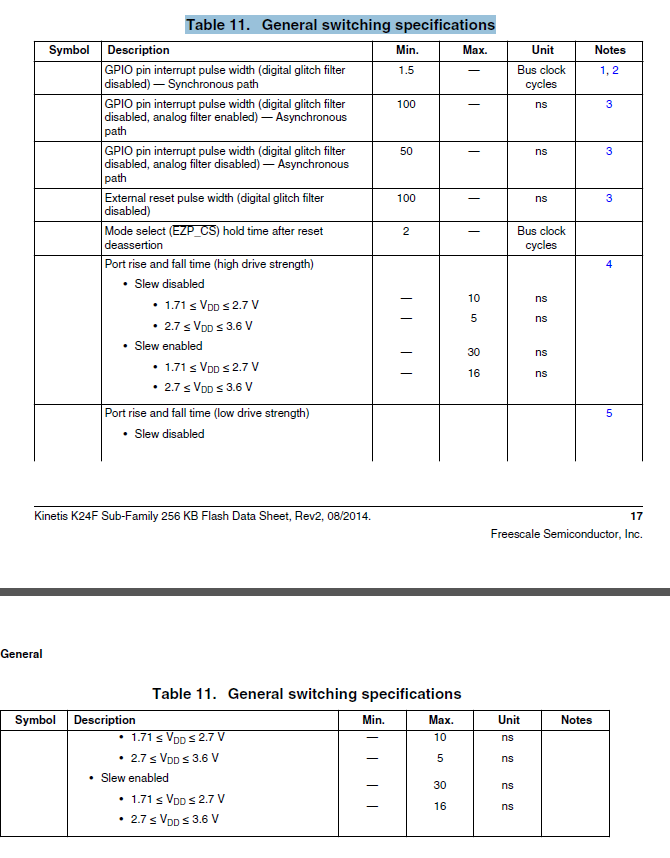

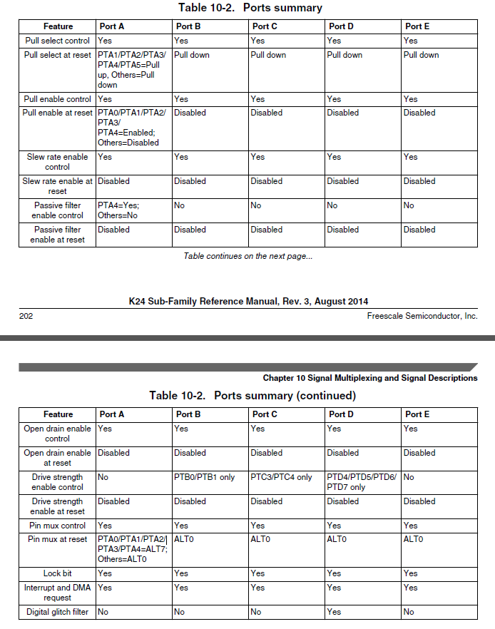

Hi Everyone, I am currently designing a Kinetis K24 based system. Does anyone know of a consolidated document or section thereof specifying port control and interrupt parameters, e.g. slew rate, drive strength, passive filter characteristics, etc. or must these be gleaned by tediously searching through various sections of the datasheet?

Hi Patrick Savage-Dickson,
    About the port control and interrupt parameters, please refer to the K24 datasheet, table 11. General switching specifications.
Besides, not all the ports support these feature, you should refer to the reference manual, 10.2.2 Port control and interrupt summary
Wish it helps you!
