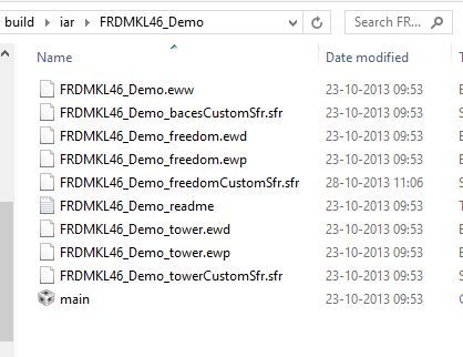

amanjain
I am using KDS V3.0. I'm not sure how to open the file and which file will be opened to view the code. FSL.JPG
10,291 Views
kerryzhou
Hi Aman Jain,
     The sample code which I recommend your just have IAR, Codewarrior project, and don't have the KDS project.
     You can download a Codewarrior 10.6 to open it, or you can just refer to the source code and add it to your KDS project.
     The picture which you give me is the IAR project, the CW project folder is :\kinetis_kl46_sc\kinetis_kl46_sc_rev2\klxx-sc-baremetal\build\cw\FRDMKL46_Demo\kl46_FRDMKL46_Demo
     If you want to refer to the source code, you can find it from folder: kinetis_kl46_sc\kinetis_kl46_sc_rev2\klxx-sc-baremetal\src\projects\FRDMKL46_Demo
Wish it helps you!
If you still have question, please contact with me!
Jingjing
