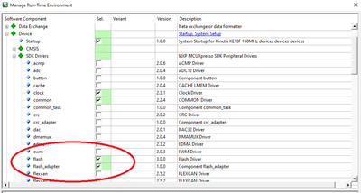

kerryzhou
Hi CEPL_Dev,
  From your log, it seems you didn't add the header file.
  Please compare with the flexnvm_eeprom project to your own project, do you lack the header file or not?
   I think the Manage Run method issue, also related to the MDK IDE.
   So, you also can add the drivers directly to your own project, then add the header file manually.
  All the SDK drivers can be found in:
SDK_2.8.0_TWR-KE18F\devices\MKE18F16\drivers
Wish it helps you!
If you still have questions about it, please kindly let me know!
Kerry

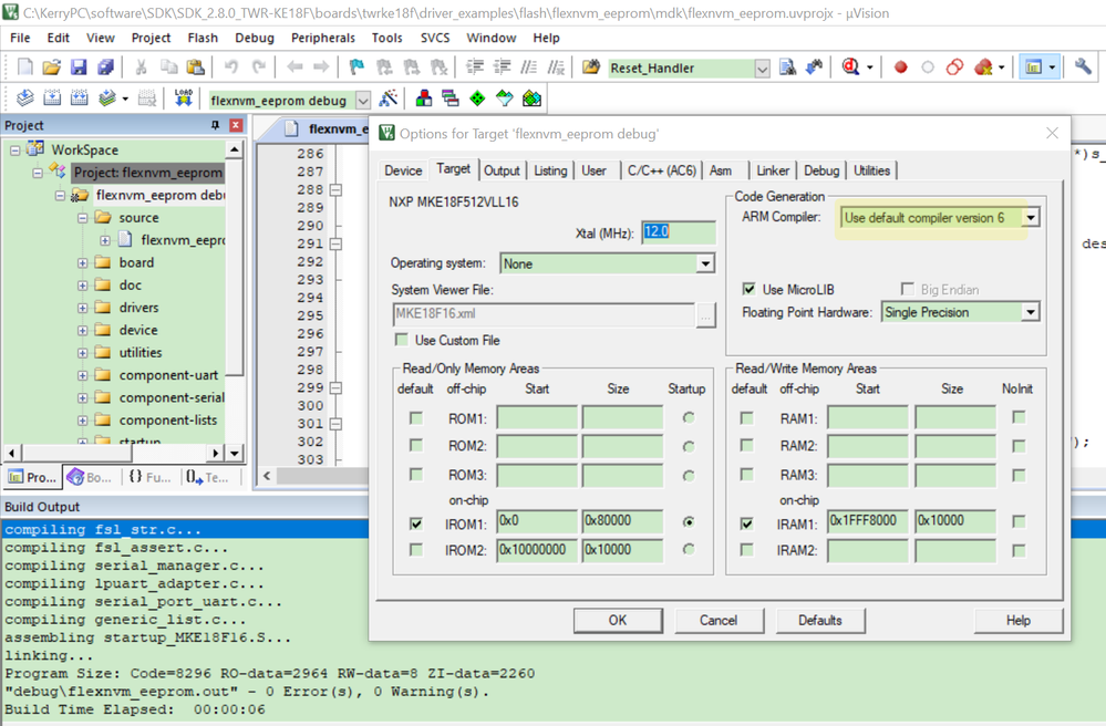

CEPL_Dev
Hi @kerryzhou ,
I removed all the files added through MDK and I tried manually adding the drivers from the folder you've specified.
Every time when I was building, I was getting dependency errors. I added around 7-8 header files the flash driver was asking and finally solved the dependencies. Still when building the project, I'm getting the following heap of errors.
Rebuild started: Project: mke18_flash

kerryzhou
Hi CEPL_Dev,
    I checked your project, also have the issues, it should be related to the MDK packs compatibility with the SDK.
   Do you mind to use the SDK flexnvm_eeprom mdk project directly?
   I use the MCUXPresso CFG tool clone one flexnvm_eeprom mdk project, it can be build correctly directly.
   You can based on that project, if you want to change the name, you can modify it directly, and if you want to delete some files, you also can delete it, this project is totally from the SDK and compatible with the SDK.
  I attached the MDK project directly, please check it on your side.
Wish it helps you!
Kerry

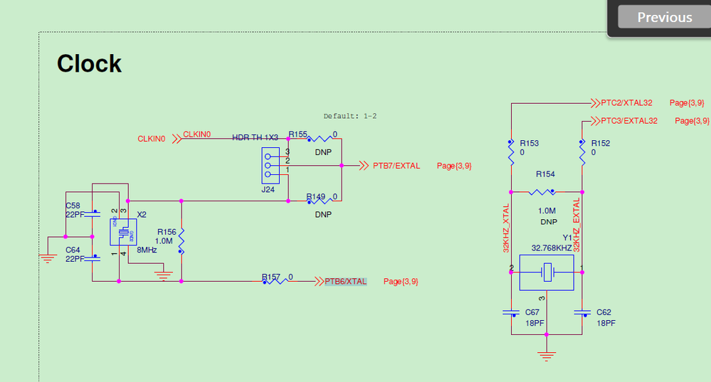

   TWR-KE18F board is also using :MKE18F512VLL16
  Please check your board schematic, do you use the external 8Mhz crystal?
The SDK code is using the external 8Mhz crystal as the clock source.
So, please check your board at first.
Any updated information, just kindly let me know.

CEPL_Dev
Hi @kerryzhou ,
I was using internal oscillator in my design. Removing the board specific initializations from the SDK code solved the issue. However I'm not going to use this in my MDK project.
I'm moving from Keil MDK to MCUXpresso  as our primary tool for development with Kinetis MCUs as recommended by everyone from NXP. I hope that will be a wiser decision in long run to avoid SDK related issues and to achieve better time to market.
Thank you so much for helping me out.

CEPL_Dev
Hi @kerryzhou ,
The example project @ SDK_2.8.0_MKE18F512xxx16\boards\twrke18f\driver_examples\flash\flexnvm_eeprom\mdk is compiling without any errors,
But when I try to add the NXP SDK Peripheral Driver to my project using the MDK Software Component Selector, I'm getting so many errors. I chose to "Auto Resolve" all dependencies when I selected the flash driver to add in to the project.
This is the build output with compiler v6.12.

CEPL_Dev
I tried using the NXP SDK, but I'm getting the following dependency errors although I selected to auto resolve all pack requirements while including the drivers in the project. A lot of macros seem to be undefined.
*** Using Compiler 'V5.06 update 6 (build 750)', folder: 'C:\Keil_v5\ARM\ARMCC\Bin'
Rebuild target 'Target 1'
assembling startup_MKE18F16.s...
compiling fsl_ftfx_flash.c...
C:\Keil_v5\ARM\PACK\NXP\MKE18F16_DFP\12.2.0\drivers\fsl_ftfx_flash.c(82): warning:  #1296-D: extended constant initialiser used
  static volatile uint32_t *const kFPROTL = (volatile uint32_t *)(uint32_t)&FTFx_FPROT_LOW_REG;
C:\Keil_v5\ARM\PACK\NXP\MKE18F16_DFP\12.2.0\drivers\fsl_ftfx_flash.c(582): warning:  #186-D: pointless comparison of unsigned integer with zero
          for (uint32_t i = 0U; i < (uint32_t)MAX_FLASH_PROT_REGION_COUNT;
C:\Keil_v5\ARM\PACK\NXP\MKE18F16_DFP\12.2.0\drivers\fsl_ftfx_flash.c(617): warning:  #1296-D: extended constant initialiser used
          static volatile uint32_t *const kFPROTLx = (volatile uint32_t *)(uint32_t)&FTFx_FPROTL3_REG;
C:\Keil_v5\ARM\PACK\NXP\MKE18F16_DFP\12.2.0\drivers\fsl_ftfx_flash.c(633): warning:  #186-D: pointless comparison of unsigned integer with zero
                  if (regionCounter < (uint32_t)MAX_FLASH_PROT_REGION_COUNT)
C:\Keil_v5\ARM\PACK\NXP\MKE18F16_DFP\12.2.0\drivers\fsl_ftfx_flash.c(1147): error:  #20: identifier "FSL_FEATURE_FLASH_HAS_ACCESS_CONTROL" is undefined
      config->flashDesc.feature.hasXaccControl = FSL_FEATURE_FLASH_HAS_ACCESS_CONTROL;
C:\Keil_v5\ARM\PACK\NXP\MKE18F16_DFP\12.2.0\drivers\fsl_ftfx_flash.c(1181): error:  #20: identifier "FSL_FEATURE_FLASH_PFLASH_START_ADDRESS" is undefined
          pflashStartAddress        = FLASH0_FEATURE_PFLASH_START_ADDRESS; /* get P-Flash start address */
C:\Keil_v5\ARM\PACK\NXP\MKE18F16_DFP\12.2.0\drivers\fsl_ftfx_flash.c(1182): error:  #20: identifier "FSL_FEATURE_FLASH_PFLASH_BLOCK_SIZE" is undefined
          pflashBlockSize           = FLASH0_FEATURE_PFLASH_BLOCK_SIZE;
C:\Keil_v5\ARM\PACK\NXP\MKE18F16_DFP\12.2.0\drivers\fsl_ftfx_flash.c(1183): error:  #20: identifier "FSL_FEATURE_FLASH_PFLASH_BLOCK_COUNT" is undefined
          pflashBlockCount          = FLASH0_FEATURE_PFLASH_BLOCK_COUNT;
C:\Keil_v5\ARM\PACK\NXP\MKE18F16_DFP\12.2.0\drivers\fsl_ftfx_flash.c(1184): error:  #20: identifier "FSL_FEATURE_FLASH_PFLASH_BLOCK_SECTOR_SIZE" is undefined
          pflashBlockSectorSize     = FLASH0_FEATURE_PFLASH_BLOCK_SECTOR_SIZE;
C:\Keil_v5\ARM\PACK\NXP\MKE18F16_DFP\12.2.0\drivers\fsl_ftfx_flash.c(1185): error:  #20: identifier "FSL_FEATURE_FLASH_PFLASH_BLOCK_WRITE_UNIT_SIZE" is undefined
          pflashBlockWriteUnitSize  = FLASH0_FEATURE_PFLASH_BLOCK_WRITE_UNIT_SIZE;
C:\Keil_v5\ARM\PACK\NXP\MKE18F16_DFP\12.2.0\drivers\fsl_ftfx_flash.c(1186): error:  #20: identifier "FSL_FEATURE_FLASH_PFLASH_SECTOR_CMD_ADDRESS_ALIGMENT" is undefined
          pflashSectorCmdAlignment  = FLASH0_FEATURE_PFLASH_SECTOR_CMD_ADDRESS_ALIGMENT;
C:\Keil_v5\ARM\PACK\NXP\MKE18F16_DFP\12.2.0\drivers\fsl_ftfx_flash.c(1187): error:  #20: identifier "FSL_FEATURE_FLASH_PFLASH_SECTION_CMD_ADDRESS_ALIGMENT" is undefined
          pflashSectionCmdAlignment = FLASH0_FEATURE_PFLASH_SECTION_CMD_ADDRESS_ALIGMENT;
C:\Keil_v5\ARM\PACK\NXP\MKE18F16_DFP\12.2.0\drivers\fsl_ftfx_flash.c(1222): error:  #20: identifier "FSL_FEATURE_FLASH_PFLASH_RESOURCE_CMD_ADDRESS_ALIGMENT" is undefined
          (uint8_t)FSL_FEATURE_FLASH_PFLASH_RESOURCE_CMD_ADDRESS_ALIGMENT;
C:\Keil_v5\ARM\PACK\NXP\MKE18F16_DFP\12.2.0\drivers\fsl_ftfx_flash.c(1225): error:  #20: identifier "FSL_FEATURE_FLASH_PFLASH_CHECK_CMD_ADDRESS_ALIGMENT" is undefined
          (uint8_t)FSL_FEATURE_FLASH_PFLASH_CHECK_CMD_ADDRESS_ALIGMENT;
C:\Keil_v5\ARM\PACK\NXP\MKE18F16_DFP\12.2.0\drivers\fsl_ftfx_flash.c(1228): error:  #20: identifier "FSL_FEATURE_FLASH_PFLASH_SWAP_CONTROL_CMD_ADDRESS_ALIGMENT" is undefined
          (uint8_t)FSL_FEATURE_FLASH_PFLASH_SWAP_CONTROL_CMD_ADDRESS_ALIGMENT;
C:\Keil_v5\ARM\PACK\NXP\MKE18F16_DFP\12.2.0\drivers\fsl_ftfx_flash.c(1274): error:  #20: identifier "FSL_FEATURE_FLASH_PFLASH_PROTECTION_REGION_COUNT" is undefined
          pflashProtectionRegionCount = FLASH0_FEATURE_PFLASH_PROTECTION_REGION_COUNT;
C:\Keil_v5\ARM\PACK\NXP\MKE18F16_DFP\12.2.0\drivers\fsl_ftfx_flash.c: 4 warnings, 12 errors
compiling fsl_ftfx_controller.c...
C:\Keil_v5\ARM\PACK\NXP\MKE18F16_DFP\12.2.0\drivers\fsl_ftfx_controller.c(158): warning:  #1296-D: extended constant initialiser used
  static volatile uint32_t *const kFCCOBx = (volatile uint32_t *)(uint32_t)&FTFx_FCCOB3_REG;
C:\Keil_v5\ARM\PACK\NXP\MKE18F16_DFP\12.2.0\drivers\fsl_ftfx_controller.c(197): error:  #20: identifier "FSL_FEATURE_FLASH_FLEX_RAM_START_ADDRESS" is undefined
      config->flexramBlockBase                = FSL_FEATURE_FLASH_FLEX_RAM_START_ADDRESS;
C:\Keil_v5\ARM\PACK\NXP\MKE18F16_DFP\12.2.0\drivers\fsl_ftfx_controller.c(198): error:  #20: identifier "FSL_FEATURE_FLASH_FLEX_RAM_SIZE" is undefined
      config->flexramTotalSize                = FSL_FEATURE_FLASH_FLEX_RAM_SIZE;
C:\Keil_v5\ARM\PACK\NXP\MKE18F16_DFP\12.2.0\drivers\fsl_ftfx_controller.c: 1 warning, 2 errors
compiling main.c...
compiling fsl_ftfx_cache.c...
compiling system_MKE18F16.c...
compiling fsl_common.c...
compiling fsl_clock.c...
compiling fsl_ftfx_flexnvm.c...
compiling flash_adapter.c...
C:\Keil_v5\ARM\PACK\NXP\MKE18F16_DFP\12.2.0\components\internal_flash\flash.h(93): warning:  #66-D: enumeration value is out of "int" range
      kHAL_Flash_SecurityStateNotSecure        = 0xc33cc33cU, /*!< Flash is not secure.*/
C:\Keil_v5\ARM\PACK\NXP\MKE18F16_DFP\12.2.0\components\internal_flash\flash_adapter.c(75): error:  #20: identifier "FSL_FEATURE_FLASH_PFLASH_BLOCK_WRITE_UNIT_SIZE" is undefined
      uint32_t progBuf[PGM_SIZE_BYTE / sizeof(uint32_t)];
C:\Keil_v5\ARM\PACK\NXP\MKE18F16_DFP\12.2.0\components\internal_flash\flash_adapter.c(193): error:  #20: identifier "FSL_FEATURE_FLASH_PFLASH_BLOCK_WRITE_UNIT_SIZE" is undefined
      uint8_t buffer[PGM_SIZE_BYTE];
C:\Keil_v5\ARM\PACK\NXP\MKE18F16_DFP\12.2.0\components\internal_flash\flash_adapter.c: 1 warning, 2 errors
".\Objects\mke18_flash.axf" - 16 Error(s), 6 Warning(s).
Target not created.
Build Time Elapsed:  00:00:03
Prasanth

Hi CEPL_Dev,
   Thanks for your updated information, you even have the orginal SDK project build issues.
   What's the SDK version you are using? and the MDK version you are using?
   I am using SDK_2.8.0_TWR-KE18F, MDK version is v5.29.
If you check the SDK release note, you can find the request tools:
3 Development tools
The MCUXpresso SDK was compiled and tested with these development tools:
• IAR Embedded Workbench for Arm version 8.50.5
• MDK-Arm Microcontroller Development Kit (Keil)® 5.31
• Makefiles support with GCC revision 9-2019-q4-major GCC9 from Arm Embedded
• MCUXpresso IDE v11.2.0
when I build the flexnvm_eeprom project. this is my result:
Rebuild started: Project: flexnvm_eeprom
*** Using Compiler 'V6.13.1', folder: 'C:\Keil_v5\ARM\ARMCLANG\Bin'
Rebuild Project 'flexnvm_eeprom' - Target 'flexnvm_eeprom debug'
compiling clock_config.c...
compiling pin_mux.c...
compiling flexnvm_eeprom.c...
compiling board.c...
compiling fsl_gpio.c...
compiling fsl_smc.c...
compiling fsl_debug_console.c...
compiling fsl_lpuart.c...
compiling fsl_str.c...
compiling fsl_assert.c...
compiling serial_manager.c...
compiling lpuart_adapter.c...
compiling serial_port_uart.c...
compiling generic_list.c...
assembling startup_MKE18F16.S...
linking...
Program Size: Code=8296 RO-data=2964 RW-data=8 ZI-data=2260
"debug\flexnvm_eeprom.out" - 0 Error(s), 0 Warning(s).
Build Time Elapsed: 00:00:06
So, from your log, your compiler version is not correct.
Please also following the SDK_2.8.0_TWR-KE18F\docs\Getting Started with MCUXpresso SDK.pdf
And test it again.
Wish it helps you!
Kerry
