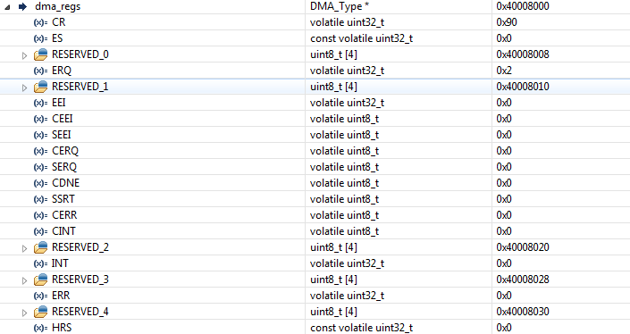

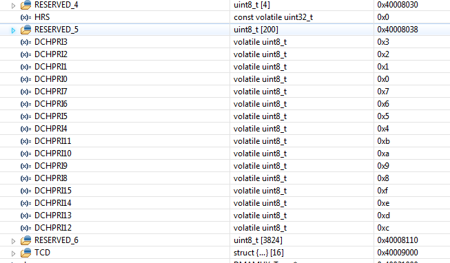

mikaelelharrar
Hi Hui_Ma,
Please found the copy screen of the register values.
9,754 Views
mikaelelharrar
Hi Ma,
I will send you the registers values.
But could you check please the Tx address and Rx address in functions "_configure_tx_transfer" and "_configure_rx_transfer" ? It is true ?
Mikael
9,753 Views
Hui_Ma
Hi Mikael,
I checked the Tx address and Rx address in functions "_configure_tx_transfer" and "_configure_rx_transfer"  are correct.
Ma Hui
