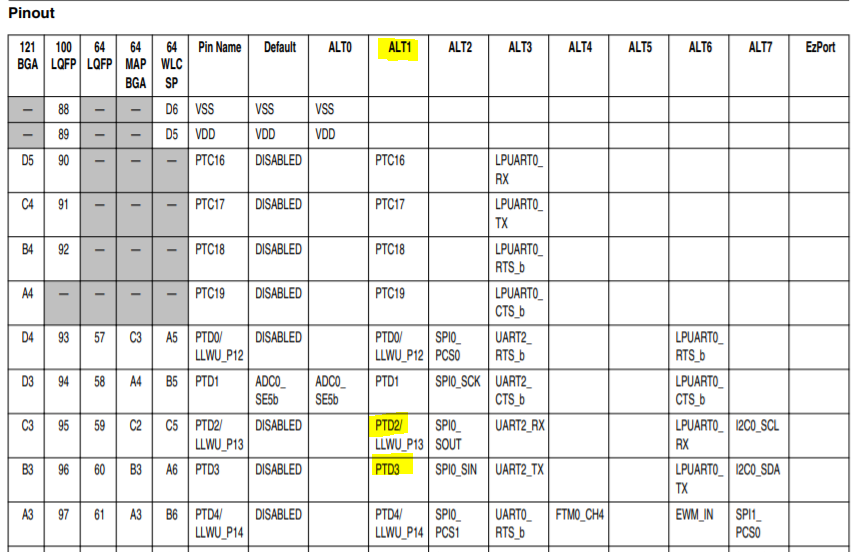

So the two pins I'm working on are pins 59 and 60 on the 64 pin MK22FN micro, thus my code I thought was correct is shown below, but that doesn't seem correct. What am I missing?
  PORTD_PCR2 |= (PORT_PCR_MUX(1));
  PORTD_PCR3 |= (PORT_PCR_MUX(1));

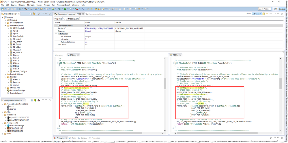

Considering that you are using Processor Expert, you can refer the function generated by Processor Expert.
  /* Enable device clock gate */
  /* SIM_SCGC5: PORTD=1 */
  SIM_SCGC5 |= SIM_SCGC5_PORTD_MASK;
  /* Configure pin as output */
  /* GPIOD_PDDR: PDD|=4 */
  GPIOD_PDDR |= GPIO_PDDR_PDD(0x04);
  /* Set initialization value */
  /* GPIOD_PDOR: PDO|=4 */
  GPIOD_PDOR |= GPIO_PDOR_PDO(0x04);
  /* Initialization of pin routing */
  /* PORTD_PCR2: ISF=0,MUX=1 */
  PORTD_PCR2 = (uint32_t)((PORTD_PCR2 & (uint32_t)~(uint32_t)(
                PORT_PCR_ISF_MASK |
                PORT_PCR_MUX(0x06)
               )) | (uint32_t)(
                PORT_PCR_MUX(0x01)
  /* GPIOD_PDDR: PDD|=8 */
  GPIOD_PDDR |= GPIO_PDDR_PDD(0x08);
  /* GPIOD_PDOR: PDO|=8 */
  GPIOD_PDOR |= GPIO_PDOR_PDO(0x08);
  /* PORTD_PCR3: ISF=0,MUX=1 */
  PORTD_PCR3 = (uint32_t)((PORTD_PCR3 & (uint32_t)~(uint32_t)(
                PORT_PCR_ISF_MASK |
                PORT_PCR_MUX(0x06)
               )) | (uint32_t)(
                PORT_PCR_MUX(0x01)
Robin

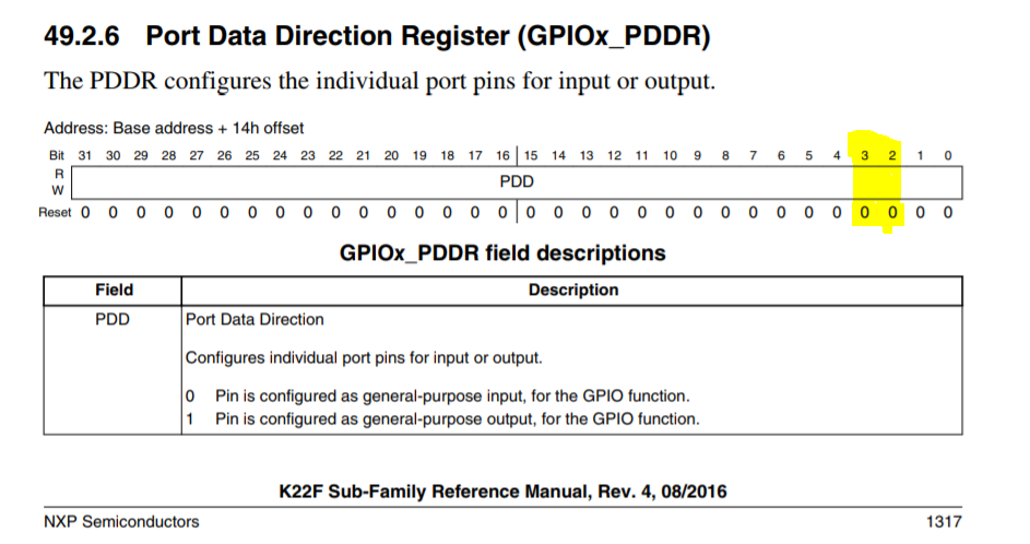

I believe it is an OR...With the bit mask why did you choose 0x040? If its pins 2 and 3 of port D wouldn't it be 0xC? Shown here?
Using your example it successfully turned one pin low, but the other hovers at 2.7 volts now and is draining a lot of current. Specifically Pin 59 which would be Port D pin 2.
This got one pin low... Which would be Port D pin 3 (pin 60)

bobpaddock
Senior Contributor III
The 0x40 was an arbitrary number, I picked.
As I said didn't have data sheet at hand.
0x0C would be correct as you showed.
For an OR not not use the compliment operator '~'.
