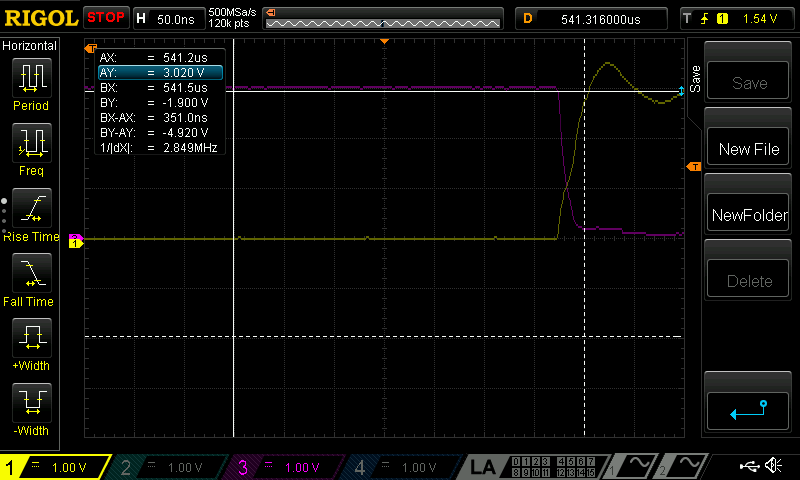

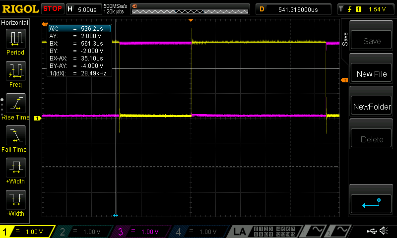

I want to run #FRDMKW41ZUG  board with #MKW41Z mcu, using  frdmkw41z_driver_examples_tpm_combine_pwm example with #deadtime insertion, but cannot run it well. I try to change filter register directly with no result.
You can see that no deadtime insertion.

Is anybody who run it well?
1,931 Views
gerardo_rodriguez
Helllo Vitaliy,
I have reported this issue to the SW team. I will update this thread when a resolution is available.
