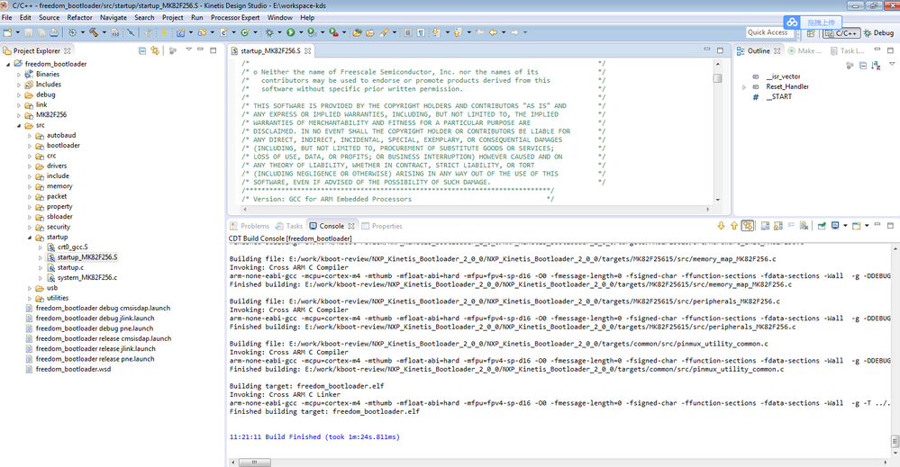

I have a FRDM-K82F: Freedom Development Platform for K82, K81. I am trying to compile freedom_bootloader in KDS 3.2.0 and I am getting error. Document has the procedure for IAR but i am using KDS.
Document has below procedure
"Select C/C++ Compiler, and the preprocessor tab. Scroll down in the defined symbols. Note that all unused interfaces are disabled. This is done to save code size and remove un needed interfaces."
I am not seeing any respective setting in KDS.
If I try to compile then i am getting linker error.
Any comments please.

Hi R.Dhanapal:
Just did a quick test on KBOOT with Frdm-k82, it can compile  successfully with KDS 3.2 on my side. I would suggest you download from MCU Bootloader|NXP  and try it again.
NXP_Kinetis_Bootloader_2_0_0\NXP_Kinetis_Bootloader_2_0_0\targets\MK82F25615\kds\freedom_bootloader

dhanapal_rajend
Hi Daniel,
Thank you very much for your support. Fresh copy of source is getting compiled. Old copy of source which is in my PC has some problem.
