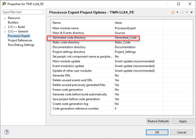

Hello EveryOne, I use codewarrior11 ProcessorExpert to configure 2 pins as GPIO input type, then choose to generate code, but I can not find the generate code, where can I find the code, thanks.

By default it is in Generated_Code. You can configure this, see https://mcuoneclipse.com/2012/03/09/shared-files-maintained-by-processor-expert/

Thanks,the problem is fixed.
