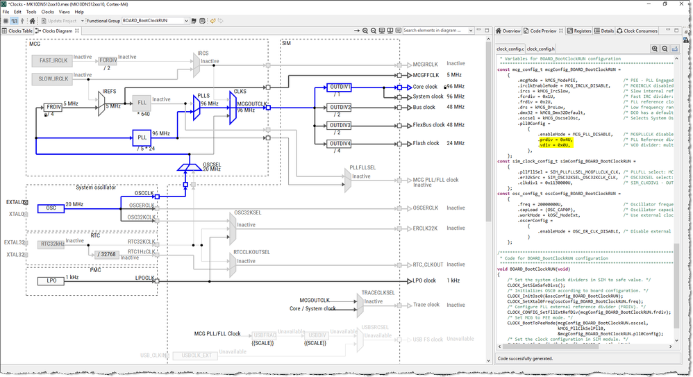

First I set the parameters
const mcg_config_t mcgConfig_BOARD_BootClockRUN =
        .mcgMode = kMCG_ModePEE,                  /* PEE - PLL Engaged External */
        .irclkEnableMode = kMCG_IrclkEnable,      /* MCGIRCLK enabled, MCGIRCLK disabled in STOP mode */
        .ircs = kMCG_IrcSlow,                     /* Slow internal reference clock selected */
        .fcrdiv = 0x0U,                           /* Fast IRC divider: divided by 1 */
        .frdiv = 0x0U,                            /* FLL reference clock divider: divided by 32 */
        .drs = kMCG_DrsLow,                       /* Low frequency range */
        .dmx32 = kMCG_Dmx32Default,               /* DCO has a default range of 25% */
        .oscsel = kMCG_OscselOsc,                 /* Selects System Oscillator (OSCCLK) */
        .pll0Config =
                .enableMode = MCG_PLL_DISABLE,    /* MCGPLLCLK disabled */
                .prdiv = 0x2U,                   /* PLL Reference divider: divided by 25 */
                .vdiv = 0x20U,                    /* VCO divider: multiplied by 48 */
                //.prdiv = 0x18U,                   /* PLL Reference divider: divided by 25 */
                //.vdiv = 0x18U,                    /* VCO divider: multiplied by 48 */
const sim_clock_config_t simConfig_BOARD_BootClockRUN =
        .pllFllSel = SIM_PLLFLLSEL_MCGPLLCLK_CLK, /* PLLFLL select: MCGPLLCLK clock */
        .er32kSrc = SIM_OSC32KSEL_RTC32KCLK_CLK,  /* OSC32KSEL select: RTC32KCLK clock (32.768kHz) */
        .clkdiv1 = 0x01130000U,                    /* SIM_CLKDIV1 - OUTDIV1: /1, OUTDIV2: /2, OUTDIV3: /2, OUTDIV4: /4 */
const osc_config_t oscConfig_BOARD_BootClockRUN =
        .freq = 20000000U,                        /* Oscillator frequency: 50000000Hz */
        .capLoad = (OSC_CAP0P),                   /* Oscillator capacity load: 0pF */
        .workMode = kOSC_ModeExt,                 /* Use external clock */
        .oscerConfig =
                .enableMode = kOSC_ErClkEnable,   /* Enable external reference clock, disable external reference clock in STOP mode */
My external clock is 20000000 so I set prdiv = 0x2U and vdiv = 0x20U in order to get PLL = 100000000 (maximum system clock for MK10DN512)
And prescalers clkdiv1 = 0x01130000U to get SYS_CLK = PLL and BUS_CLK = PLL/2

It stacks at function CLOCK_SetPbeMode on
while ((MCG->S & (MCG_S_IREFST_MASK | MCG_S_CLKST_MASK)) !=
           (MCG_S_IREFST(kMCG_FllSrcExternal) | MCG_S_CLKST(kMCG_ClkOutStatExt)))
How can I configure clocks?

The problem was prdiv = 0x2U and vdiv = 0x20U - it's not absolute values - it bits in registers.
now SYS_CLK = 96000000 BUS_CLK = 48000000

Hi Evgeny Erenburg,
The MCUXpresso Clock Tools will generate these codes by itself after you configure the corresponding clock.
You don't need to manually modify these codes.
