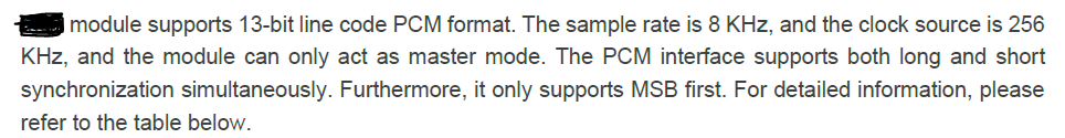

I'm looking for a Kinetis MCU have a hardware enough for my project with requirement : 5/6 UART, 4 PCM, 1 USB ports, Fcyc >100MHZ, can support interface with SD card, SD/DDRAM.
I looked on highest version of Kinestis but cant choose a MCU suitable.
Please help me to choose right part

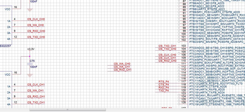

Now I map connection from GSM module to MK60FN1M0VLQ12
But some pin not have same your define
Please help me to check it

As you see in the following figure for K60 with 144 pin package. K60 has two I2S module:I2S0 and I2S1.
I suppose that you can connect the GSM with I2S as following:
I2S0_TX_BCLK of K60 to I2S_CLK_CH0 and I2S_CLK_CH1
I2S0_TX_FS of K60      to I2S_WA_CH0  and I2S_WA_CH1
I2S0_TXD0                   to I2S_RXD_CH0
I2S0_TXD1                   to I2S_RXD_CH1
I2S0_RXD0                   to I2S_TXD_CH0
I2S0_RXD1                   to I2S_TXD_CH1
BTW, I suggest you use asychronous mode, in the case,
I2S0_TX_BCLK to I2S0_RX_BCLK
I2S0_TX_FS      to I2S0_RX_FS
The I2S0 transmitter is master, the I2S0 receiver is slave.
Hope it can help you

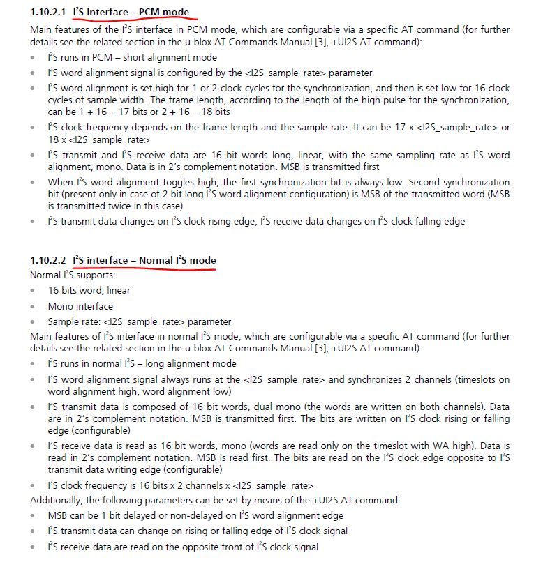

Hi, Tien,
As you said that the GSM module supports slave mode, and I2S mode or normal mode. I suppose that you use K60 which has two SAI modules:SAI0 and SAI1.
This is the connection:
SAI0_TX_BCLK: GSM0 and GSM1 Receiver bit clock
SAI0_TX_SYNC:GSM0 and GSM1 Receiver Frame clock
SAI0_TX_DATA0: GSM0 Rx
SAI0_TX_DATA1:GSM1 RX
SAI0_RX_BCLK: GSM0 and GSM1 Transmitter bit clock
SAI0_RX_SYNC:GSM0 and GSM1 transmitter Frame clock
SAI0_RX_DATA0: GSM0 Tx
SAI0_RX_DATA1:GSM1 TX
If the GSM module use the same bit clock and frame clock for both transmitter and receiver, you just need to conncet SAI0_TX_BCLK to SAI0_RX_BCLK, SAI0_TX_SYNC to SAI0_RX_SYNC, while set the SAI0 transmitter as master, set SAI0 receiver as slave, it is okay.
For SAI1 module, it is connected to GSM2 and GSM3, pls refer to SAI0 connection.
Regarding the mode, from the description you gave, the GSM module supports mono mode, in other words, it only supports single channel. If you use I2S mode, you can fill the second channel with a dummy data.
If you use I2S mode, each frame convers two channel(first channel is valid data, second channel is dummy data), assume one bit frame clock, sample rate is 48KHz, the required  I2S bit clock frequency:
48KHz*17bits*2=1.632MHz. The bit clock frqeuency is not related to data channel, it is only related to slots number
If you can generate 1.632MHz or integer times frequency of 1.632MHz as MCLK, it is okay.
From your description, the GSM module only support I2S or normal mode, i do not know if it can support TDM mode.
In I2S mode, there are only two slots: first slot and second slot.
in normal mode, there are multiple slots, but only first slot includes valid data, the other slots includes dummy data.
In TDM mode, there are multiple slots, all slots includes valid data, but the GSM must be set to know which slot is a valid slot for itself.
I think there can be one slot in normal mode for GSM module, in the case, the required bit clock is 48KHz*17bits=816KHz

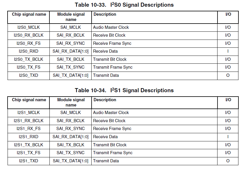

Pls confirm whether the GSM modules support slave mode, if GSM module supports slave mode, it is simple, you can use the Kinetis processor with 2 SAI modules.
For example, you can use K60, this is the features of SAI of K60. One SAI master can connect with two slave GSM modules, because each sai has two tramsmitter data lines and two receiver data lines.
Regarding TDM modes, it does not matter whether you use I2S mode or TDM mode, it is important whether the GSM supports slave mode.
Hope it can help you.
Xiangjun Rong
3.9.9.1 Instantiation information
This device contains two I2S modules.
As configured on the device, module features include:
• TX data lines per module: 2
• RX data lines per module: 2
• FIFO size (words): 8
• Maximum words per frame: 32
• Maximum bit clock divider: 512

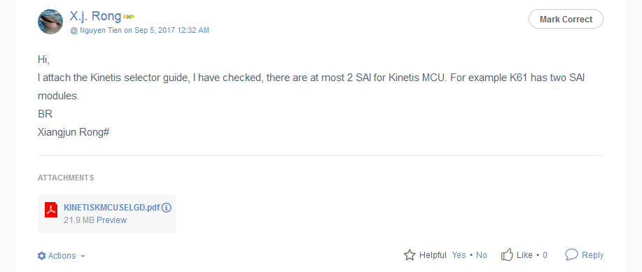

xiangjun_rong
I attach the Kinetis selector guide, I have checked, there are at most 2 SAI for Kinetis MCU. For example K61 has two SAI modules.
Xiangjun Rong#

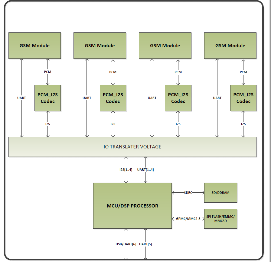

I draw an block function which ma help you o understand my perpose
Please review and give a suggest for me if can
Thank for your support

xiangjun_rong
Hi, Nguyen,
can you tell me whether the GSM module is master or the GSM module is slave?
If all the GSM module is slave, i suppose that you can use the kinetis with two SAI modules for example K28. One SAI module can interface with two GSM slave, for example, connect PCM_CLK/PCM_SYNC signals  of K28 SAI to two GSM module respectively, connect the I2S0_TX0/I2S0_RX0 to one GSM, connect the I2S0_TX1/I2S0_RX1 to another GSM, it is okay. For another SAI module I2S1, it is the same as that of I2S0 module.
If the GSM module has to be master, it is another story, you have to use 4 SAI modules to interface. in the case, you have to select the processor with 4 SAI modules, you can refer to i.mx or the other chips.
Xiangjun Rong
