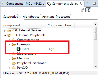

Hi all,
    I am testing External Interrupt function with TRK-KEA128 now, but there never trigger the isr so need help.
1) Using CW10.6, ProcessorExpert to generate ExInt
2) Could only choose PTI4 for input (why? datasheet says PTI0~PTI6 could be set)
3) Input waveform with 10KHz, 1us width, 5V amplitude.
   Any help is appreciated.

How are you configuring the IRQ module because I can use PTI0 ~ PTI6 as IRQ pin and it works well? Here is the Init_IRQ component configuration:
I created a simple project where i trigger the IRQ everytime a '0' logic is presented in PTI0. On the ISR, i toggle the blue LED. Attach is the project that I used for testing it.
I hope this helps.
Isaac

Thanks isaacavila, your setup is worked.
Somehow I don't understand why the ExInt module that I used doesn't work.
