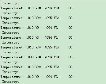

jeremyzhou
Hi Clive,
I've created a demo to read channel 26、channel 29、channel 30 and the read function is set in TPM interrupt routine.
These ADC sample results are transfered to PC(Fig 1).
                                           Fig 1
So please check the attachment and if you have any futher questions about it, just feel free to contact with me.
(my name)
