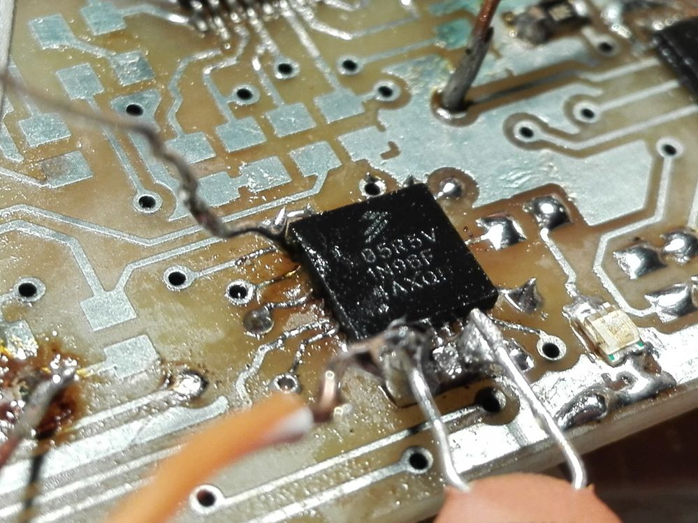

edit: in my design the NMI pin (PTB5) is not connected to anything, but I tried to add a pull-up anyway. It didn't work, I will try to add a proper pull-up and a capacitor near the RESET pin and let you know afterwards. You can see one leg of a 10kohm resistor on this picture going to a PTB5 pin.

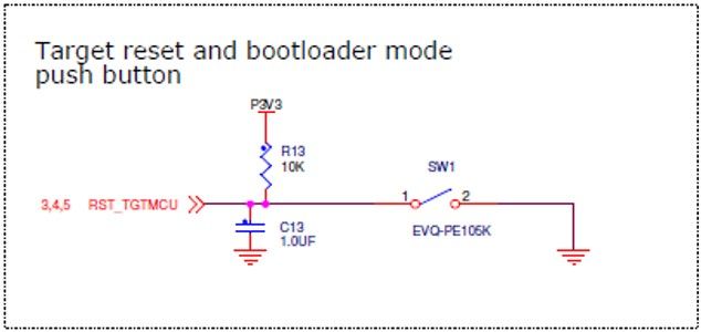

Based on FRDM-KL05Z board, you should try adding an external pull-up resistor on Reset Pin and 1uF Capacitor on it. Also, please be sure to avoid a zero-logic level on NMI pin.

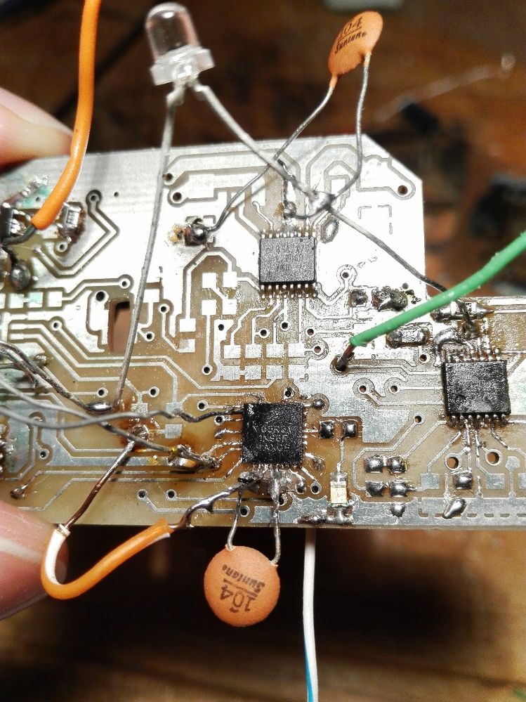

Thanks for help, I added a pull-up resistor and a capacitor on the board as presented on the RESET pin.

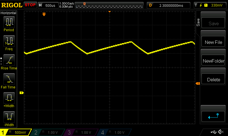

You can see them just on the right edge of the uC. The NMI pin is pulled - up. Unfortunately, this didn't work. During the programming, the voltage in time looks as follows on the RESET pin:
You can see the RESET pin goes down during the programming. The visible oscillating high state is actually a sawtooth:
Which is normal for non-programmed mkl05z - the uC just keeps turning itself on and off. The board is powered externally. Is there anything I can still do to make this thing work?
