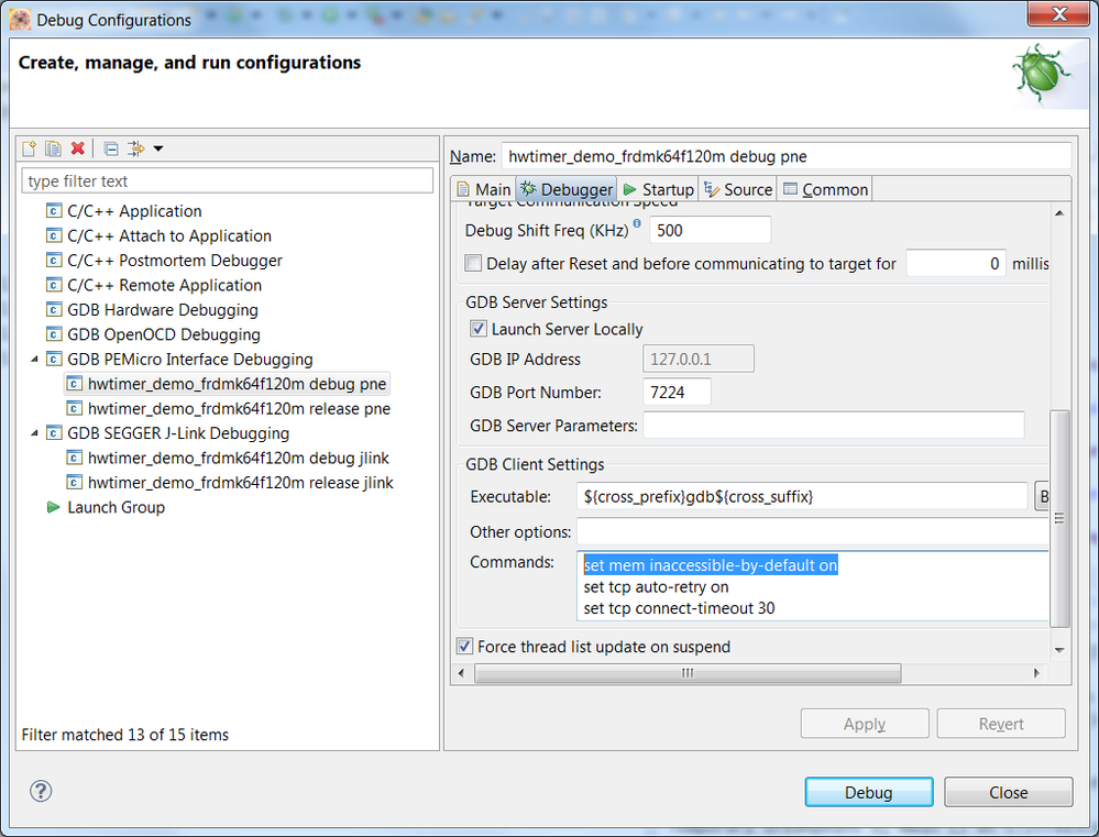

Hey - I have the same problem, and this fixed it!
Set mem inaccessible-by-default on (default was off).
I also set "Force thread list update on suspend." I don't think it matters.

Hi Donald Porada,
I would suggest checking if all items are configured correct in debug configuration.
see the attached image.

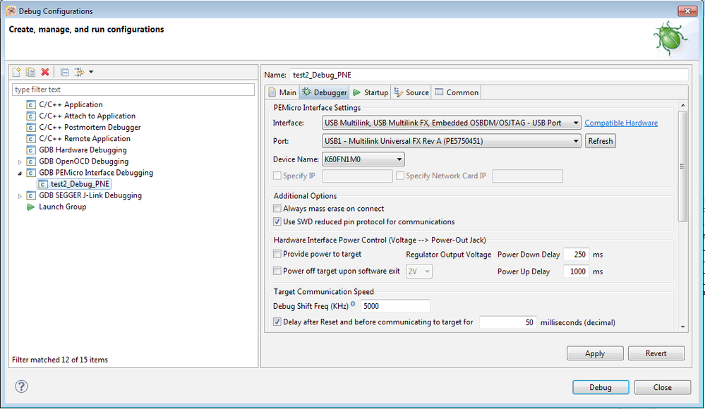

dporada
Here's what the Console says.

18,031 Views
Jorge_Gonzalez
Are you really using SWD in your custom board? If not uncheck the "Use SWD reduced pin..." option.

dporada
Jorge,
Using SWD in both KDE and CW. Unchecked just to try but didn’t work.

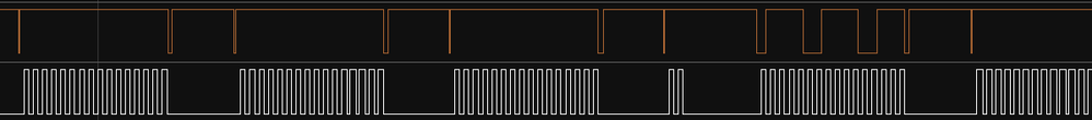

dporada
When the reset is low, here's what I get.  The top trace being the DIO, and the bottom being clock.
18,031 Views
takaoyamada
Greetings,
Thank you for the screenshot of your scope. This shows that the multilink is talking to the chip and trying to enter debug mode. However, I need the full picture. What happens when reset goes back up to high? Or does it ever go back to high? Is there any activity on DIO and TCK? If there is not, I would advise adding more reset delay than just 50ms. Maybe 200ms.

dporada
OK, with the delay set to 0, the reset goes low, communication happens every 5ms.  This repeats for 85ms and then the reset goes high.  After the reset goes high, the communication happens again in 5ms intervals 5 more times.  Then there is a 20ms delay, and then a large packet of information is sent.

dporada
Oh, the 200ms delay had no effect.
18,031 Views
dporada
Here's what I have.
