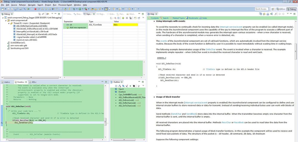

Hello:
I am developing using an asinchronical serial component created with PE. I am trying to handle an EPSON printer using a protocol called Extended Protocol.
Using a RS232 interface (termite), I have checked that when I asking the printer (using a Printer Terminal) for date and time, the printer answers the followong frame:
[06][02]•[00][00][1C]À€[1C][1C][00][00][1C][1C]110316[1C]121550[03]04DC
However, when I try to receive this data using my KE02 MCU, (using the routine AS1_OnRxChar), every byte are saved in the buffer except the 0x1C.
Is there a reason why the AS1_OnRxChar doesn't detect this byte?
The routine I am implementing is the following:
Thank you very much
void AS1_OnRxChar(void){
    AS1_TComData ch;
  if(AS1_RecvChar(&ch) == ERR_OK){
  BUFFER_AS[cont_AS] = ch;
  cont_AS++;

Hi Juan,
I have test on my FRDM-KE02Z board, using KDS3.1.0 with Processor Expert3.0.2
I can receive the 0x1C and send it back to Virtual terminal port of OpenSDA.
Would you please send me the version of your Processor Expert?
And I am a little confused about the À€ in frame " [06][02]•[00][00][1C]À€[1C][1C][00][00][1C][1C]110316[1C]121550[03]04DC "
I can't found it in ASCII table, so I haven't test your frame on my board.
Robin
