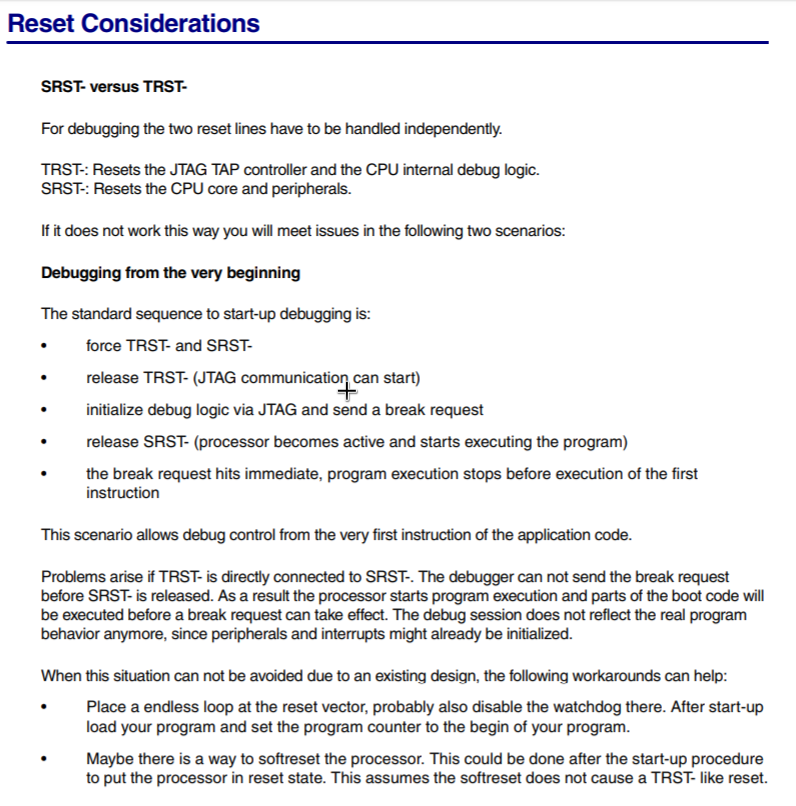

I searched about Arm Reset, and I found there are two reset (SRST- which correspond pressing Reset buttons of MCU, and another TRST- Test Reset pin which is related to JTAG controller :
Should I wire both RESET  lines  to flash again my device ?

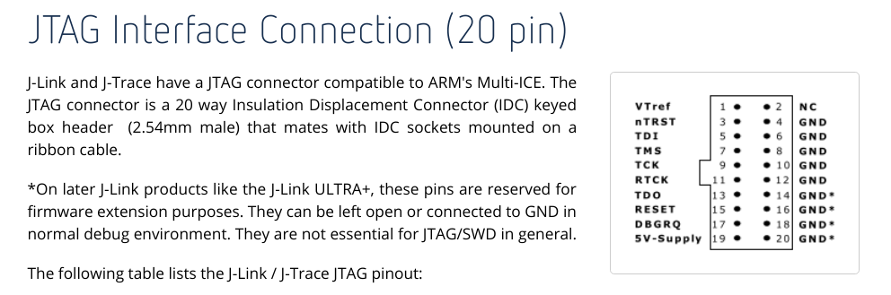

It seems my programmer supports driving these two reset pins (nTRST / RESET)

You need to connect the following Reset pin of the debugger to the SRST pin of the MCU.
Hope it helps!
