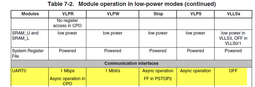

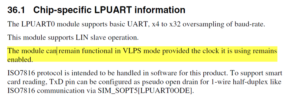

      If you check the reference manual about the LPUART and UART, you will find the difference.
     LPUART is the low power UART, it can works in the low power mode, I post some information for your reference:
1.LPUART
2. Normally UART
