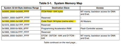

I see RAM is at 0x0000 to 0x10000. Is this fixed? If so I guess my bootloader must be from 0x10000000 to 0x1000a000 and my application can start at 0x1000a000
3,104 Views
EdwinHz
Hi @derekcook!
You are correct. The RAM address is fixed, but the code address starts at 0x1000_0000. Table 5-1 of the datasheet shows the Memory Map:
BR,
Edwin.

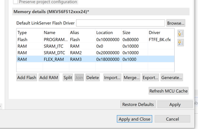

I am following this document to port the KV58F220M bootloader to the KV56. https://www.nxp.com/docs/en/reference-manual/MCUBOOTRM.pdf
With the KV31 we had our bootloader load to flash at 0xA000. We can still load to the same flash location with KV56? I noticed the default location was 0x1000a000.
