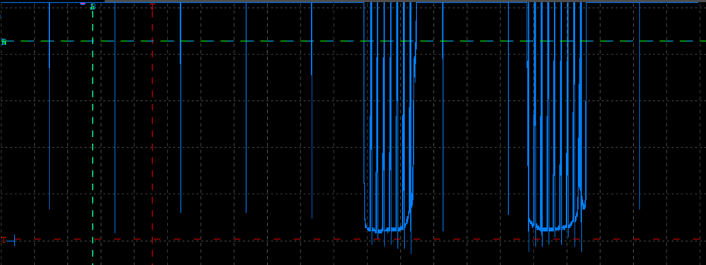

Customer can duplicate the above problem on a K70 TWR with the TWR-LCD-RGB.
. I decided to run some code on the K70 tower with the LCD-RGB add-on. I ran the WVSM2 code on it.  I wrote the graphics and touch driver from scratch for this project. Still using MQX. I just got the CR touch IC to fail.
 This time, after about 10 minutes of operation, the CR touch IC always reports that the screen is pressed and the coordinates are the same. The RTST bit is always set.See first attachment labeled Regs.
The failure is the opposite of what occurs on WiCap where it never reports a press. This failure always reports a press.
I took some screen shots of the touch screen line Y+ using an oscilloscope. During normal operation, the line looks like this:
You can see the pulses when power is removed from the touch screen film and you can see 2 presses of the screen.
However, when the failure occurred on the K70 tower, it now looks like this:
You can see that after the failure, the CR touch IC is no longer scanning the touch screen.
