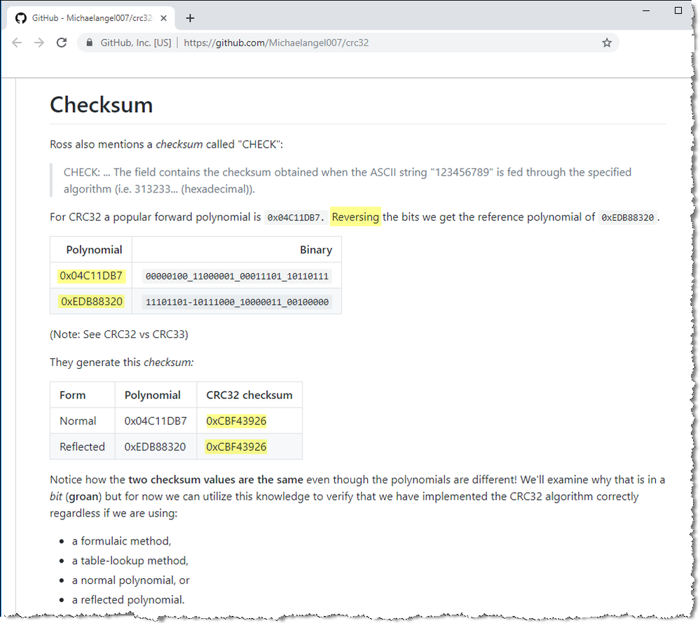

Hi Suhas,
Please refer the description of CRC32 Demystified:
There is crc example in MCUXpresso SDK_2.6.0_MK22FN512xxx12(...SDK_2.6.0_MK22FN512xxx12\boards\frdmk22f\driver_examples\crc)
In that example, we will get checksum32 == checkCrc32(0xcbf43926u).
Please have a try on that example.
