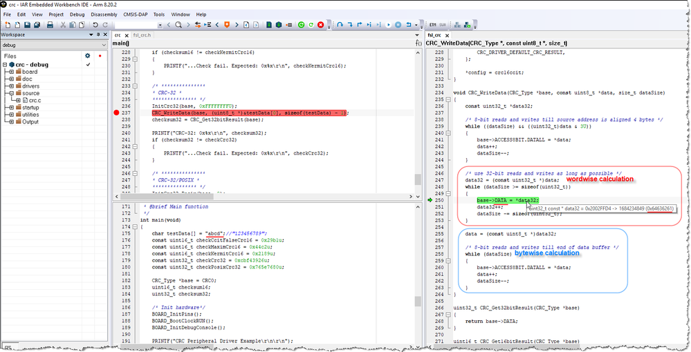

Have you try to refer the crc example in SDK_2.2_TWR-K60D100M(C:\SDK_2.2_TWR-K60D100M\boards\twrk60d100m\driver_examples\crc)?

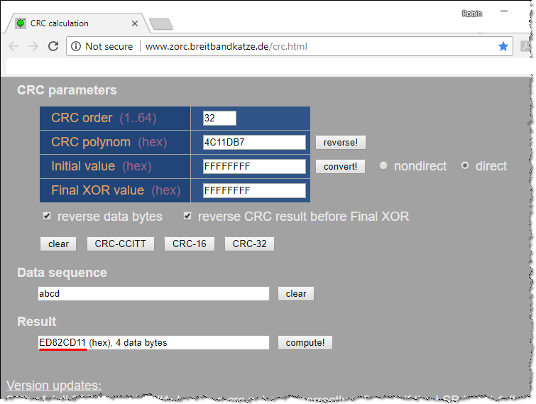

I can only get the result 0xED82CD11 by using online CRC calculation.

wordwise calculation
If you debug that example, you can see the value write into CRC_DATA is 0x64636261
