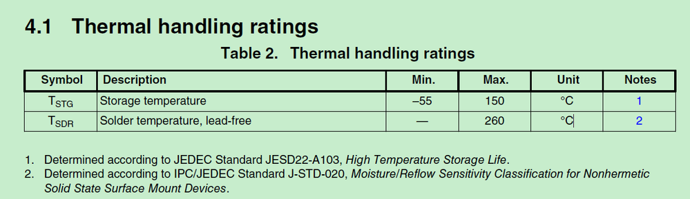

Hui_Ma
Please don't exceed the KL16 Max. solder temperature is 260°C:
Please check here to find more info about QFN board assembly info.
Wish it helps.
