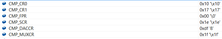

As reference, here are the register values used to setup CMP1 [using interrupts on both rising and falling senses] so that you can work out what is missing in your code (there are no further settings needed).
